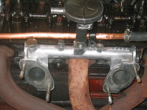

Here are some clean shots while I run out to get a close up of the rocker.
The inside is now immaculate. I can't go muc farther as I am missing a manifold stud & the fat washer that holds them in. The heatshield is also done as only about 1/4" of metal is holding it as 1 piece.
