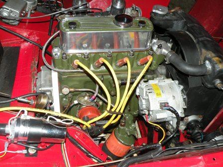

I used a Accel 8mm wire set from NAPA cut to fit and you have a spare set!
