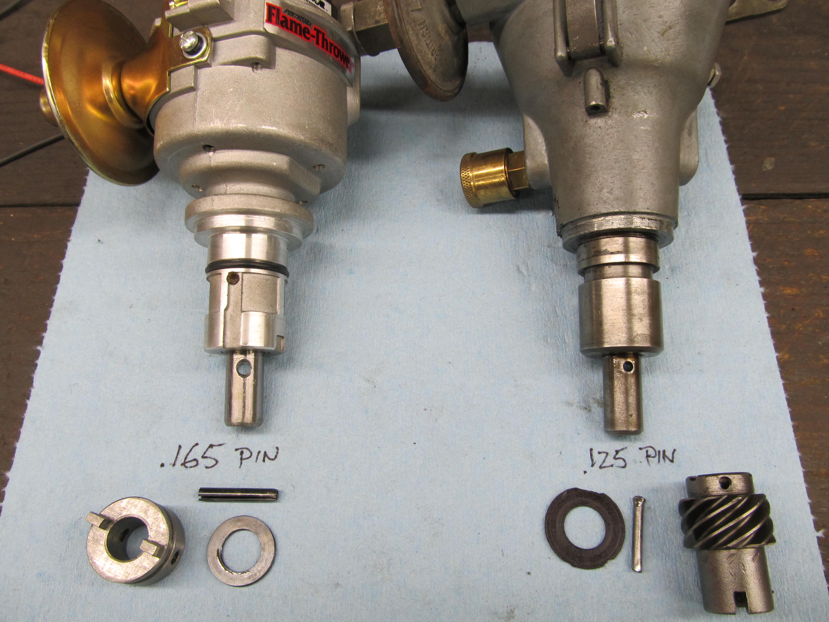

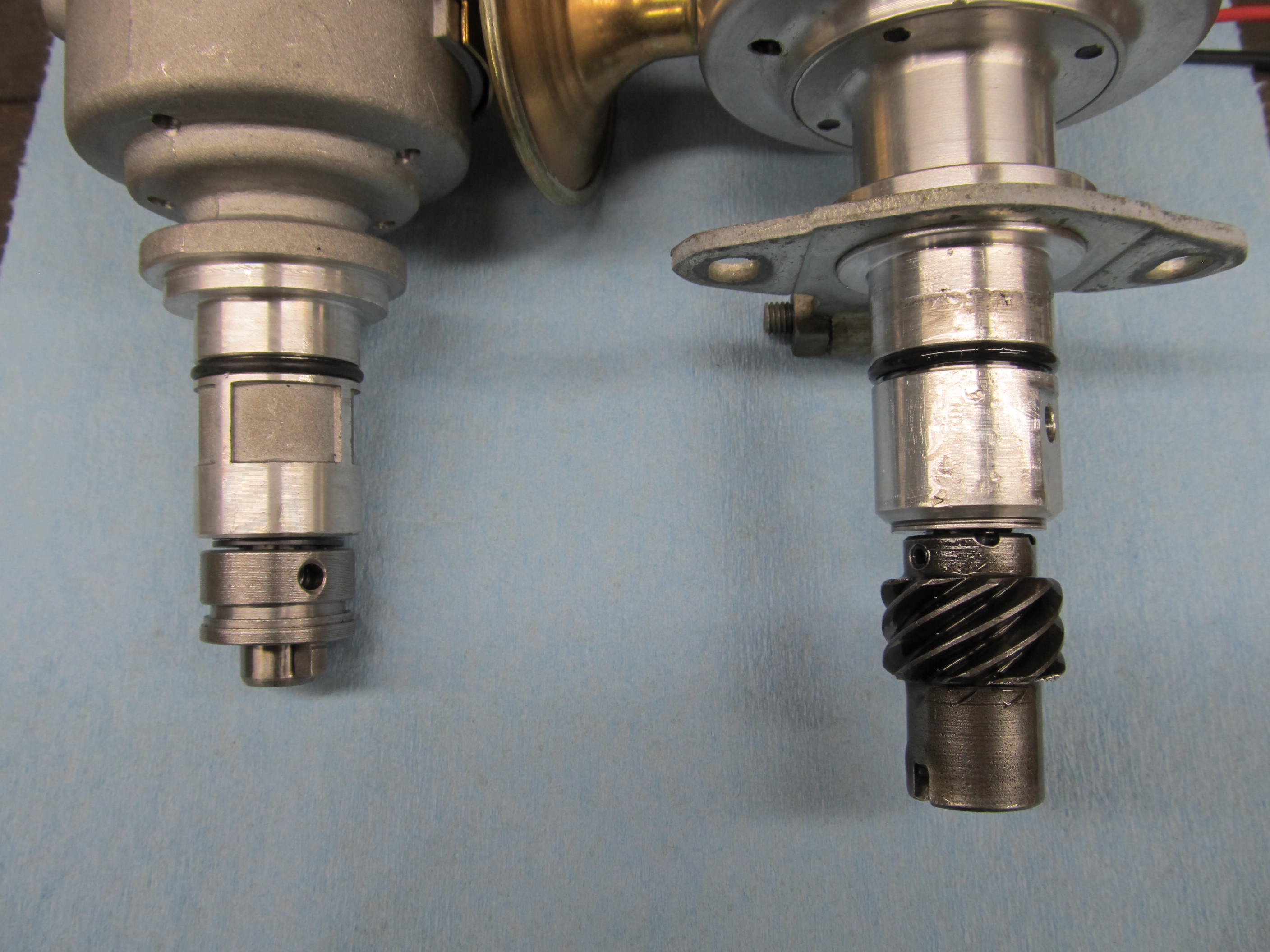

An important note if you have an early car with a cable driven tach (BN4 thru BJ7) - the Pertronix distributor sold for Healey 3000 are actually only correct for the late BJ8 with electronic tach - they come with the drive used on the BJ8 and you need to mount your old drive gear for the tach. The difficulty is that the pin holding the drive on is bigger diameter (.165") so you must drill a new, smaller hole (.125") 90 degrees from the one it comes with.
Other than installing the drive gear, I've got about 10-11k miles on it over the last 2 years, and it has proven very satisfactory for me.
Pertronix on left and stock on right in both pictures.
