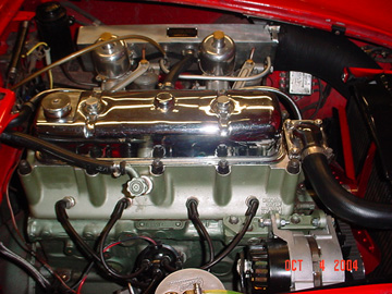

My Austin Healey has the original factory type "Le Mans" cold air intake.See attached pic. It consists of a box (manifold) over the carb intakes with an air tube leading to an area just behind the grille. There is a cone type K&N filter attached to this end. It is actually quite effective. Since air density increases about 2% for each 10 degree F. drop in temp, & the outside air temp will likely be at least 100 degrees F. cooler than the underhood temp., this is good for 20% increase in air density & power. The fuel mixture will need to be richened to suit.It keeps the carbs cooler & prevents float bowl vapor problems also.
I don't see how an intercooler would help a non supercharged engine unless it was refrigerated. The cold air intake is a proven low cost way to increase power.
