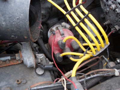

I know there is no reason to have a top entry cap, but I assure you that it does work on a LHD car. That is what is currently in the Ugly Bug.

1275, 45d dist, top entry cap, 1961 BugEye. Fits fine
'59 BE with a Mallory dizzy has Noooo problem fitting a top-mount, but then mine doesn't seem to have that gusset where the footwell meets the inner wing (fender)! ('scuse the mess! :eeek: )
