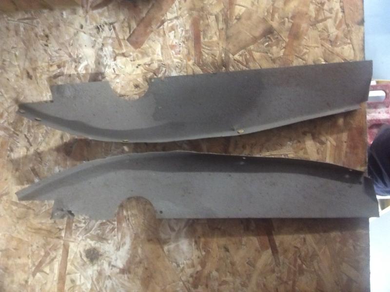

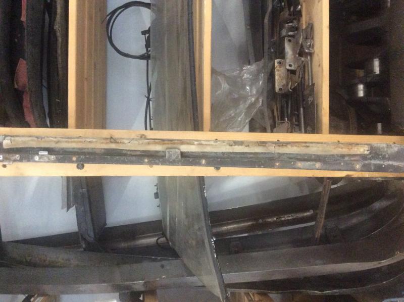

So I’m rummaging through my boxes looking for stuff and come across these.
Anyone got ideas? They are of a BT7 as far as I know, but where?
The vertical piece leaning against the shelf looks like it could be part of a soft top frame as it has a strip of fabric on it.

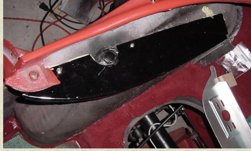

The first picture of the 2 sheet metal parts are the upper left and right side panels. Located in the rear of the door shut area along the side of the rear shroud. They get wooden panels that make up the vertical area, that go down along side the rear squab seats. The wood gets riveted on and then covered with upholstery material. the sheet metal gets carpeted. this is where the top bows get stowed. Danny
Tks Danny , would you have a pic by chance of the area in the car ?
Found it ?
anybody for the other piece leaning on the shelf ?

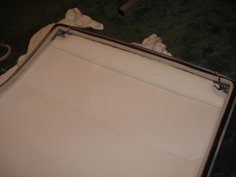

Did you ever have a hard top? That looks like the front header panel on a hard top. Would have been covered with headliner material.
I do have the original hardtop that was sold with the car when new ,correct serial # on the frame of the top . I will have to have a look at it closer to see if it’s part of it .
Healeyblue, how can I get to see additional photos of that good looking hardtop? I will need to work on mine over the winter months.
thank you for your assistance
