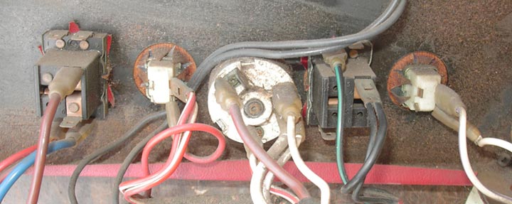

Greg to the rescue....again. How do you get to, shoot those great photos. Wow.
One photo; shows exactly what/which wire attaches to where on each switch. Right on! (pisst, hey Greg, I noticed a little dust up there, whatsupwiththat)....(Oh and that double black wire that doesn't play well with others, the one that just seems to be traveling alone from the right top to the left bottom of the photo...Yeah, it's just there so we'll ask, and what about that wire?) That's the secret wire
The double black wires are not both black. They are the ground wires that complete the heater fan circuit when you turn on the heater. I think.
Just having fun with Sir Greg. You can always count on him.
From the photo, one solid black, one black with white stripe.
Cheers, Roger
If you remember my in-dash espresso machine Roger, those black wires are the power for that.
Actually Cutlass has it right, they are the heater switch wires. But they aren't ground wires. They splice into the harness to a green wire and a green/yellow wire.
