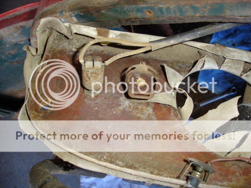

This is the heater reostat..on the right of the pic, with no guts in it. When it was new, it was made of a white porcelain.
This is a shot of the panel reostat...the one with the orange wires going into it. It is smaller, and usually made of black bakelight material.

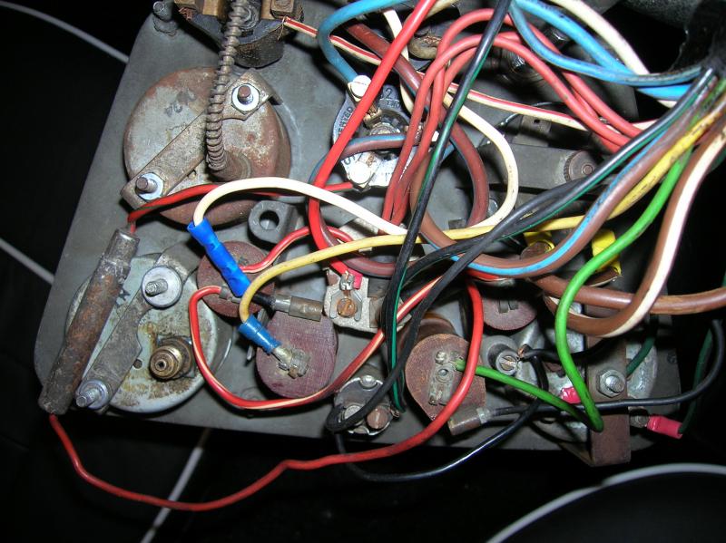

Is there any way to test the head/tail light switch to determine it is truly off in the off position. I thought that was a possibility but couldn't see how to determine it was actually off. I was working on this problem yesterday and, as I remember, when power was applied the tail lights came on without any other switches on. I could be wrong. Just now I had to turn the ignition on for the tail lights to come on without any other switches on. I removed the fuse and the tail lights stayed on. Nothing else is connected to S1. I have the dash out, hanging by wires, the water temp line and the choke cable. Attached a picture but it's so dark and such a rats nest I doubt it's useful. Light and flash didn't help.
The wiring diagram I'm using came from "Practical Hints for the Maintenance of the T.R.3", sixth edition. It's the one with the rear parking lights.

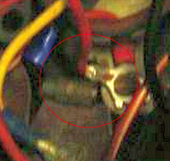

Looking at your photo, I'm wondering if perhaps the white connection to the generator warning light isn't touching the terminal on the rheostat. They seem awfully close together. Might be that if you just turned the bulb holder the other way, the problem would disappear.
Also, I assume that red wire at the wiper switch isn't actually going to the wiper switch. Hard to tell where it does go, though.
Randall, sorry for the poor picture. Although very close none of the wires are touching. The red wire is actually the other end of the fuse holder and goes to the panel rheostat. The fuse holder wiring starts out RG as it should but changes to red at that end of the holder. I'll re-position wires and see if I can get a better picture. Thanks for the help.
Must be just the angle, then.

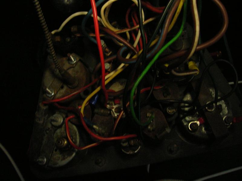

Was the angle. That red wire goes to the lights in the speedo and tach and is lower than the generator light post. Didn't have red/white wire as called for. I'm giving up for the day. After awhile you forget what you've checked and what you haven't. Been chasing this problem for several hours with no results, actually things have gotten worse. Now nothing works, not even the horn and, somehow I've got power on the ground wire at the control box. Have no idea how that is happening. I've attached what I hope is a better picture if you want to take a look. Have power on A, A1, and both ends of both fuses yet nothing works. Go figure.
That shouldn't be too hard to chase down, and I'd do that next. Bad grounds cause all sorts of strange symptoms.
I believe there should be two wires on the 'E' terminal, one of them should be tied to the body nearby. Check that tie point (on my car it is screwed through the edge of the battery box). If it's grounded, then the wire to the E terminal is broken or not making good contact. If you find 12v there too, then the battery ground strap isn't making good contact to the body. Actually a common problem if the body has been recently repainted, as paint doesn't conduct. A big 'star' type lock washer between the ground strap and the body will help make sure it makes good contact (the points of the star cut through the paint).
The wires look pretty nice to me considering all that gets stuffed in that tight spot. I recently put a new wiring harness in a 61 tr3 with the rheostat and I remember dealing with a spot for 3 wires on that rheostat; it was painful. I had problem with dash lights somewhere where they hooked into the headlight switch for power. Moreover, I think the problem I had was I was putting the tail lights on the wrong peg of the light switch; the tail lights needed to be on at both pulls of the switch, parking and headlights. I did add a fuse for the tail lights circuit. I hope that helps. I am curious what is that metal cylinder by the oil gauge?
That's the original in-line fuse holder. Normally it would be clipped to the bottom edge of the larger dash panel when the instrument panel is installed.
So there was a fuse on the headlights or taillights Randall? And if so that stock fuse/fuse holder goes to headlights or tail lights then kinda disappears at the ignition light? The wiper switch is at the bottom center of the panel in the picture, right. Just curious again the car is still positive ground, right.
The in-line fuse was for the taillights, supposedly because people were getting the rear lamps crushed and having electrical fires. But it also feeds the panel lights. According to Bill Piggott, it was added at TS38177 (although he says there was a second fuse for the brake lights, which I don't believe is correct).
Hard to see in the photo above, but the disappearing end goes to the panel rheostat, which doubles as a tie point. The 3 other red wires going to the same terminal supply power to the front marker (aka side) lights and the tail lights. Not the way I would have done it, but probably cheaper and easier than messing with a bunch of bullets and sleeves.
Yup, that's the wiper switch at the bottom of the photo (which would be the top when the panel is installed). On these later cars, the wiper switch actually grounds the motor to make it run (so the motor can park with the switch off, by grounding itself).
Looks like the ammeter is wired for negative ground; but that's the only difference under the dash. Everything else remains the same except the battery connections of course, and perhaps the ignition coil.

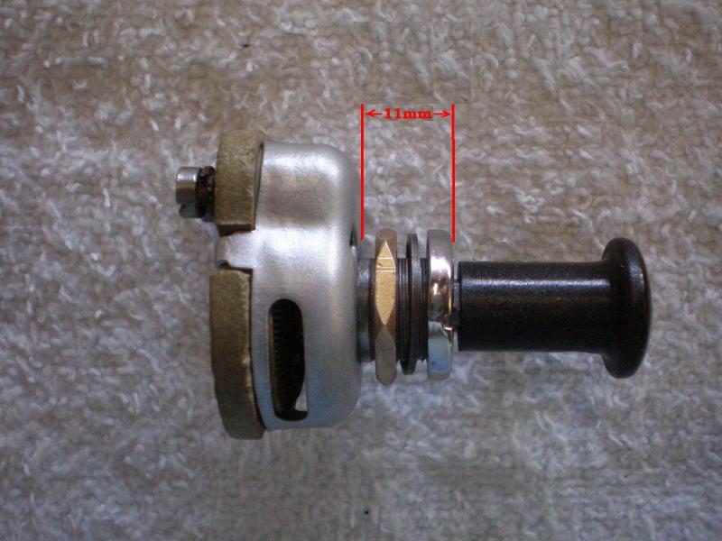

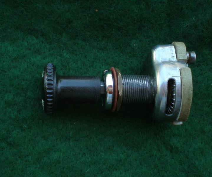

Re. the rheostats: As Randall stated, the heater rheostat as a panel rheostat is OK, but the panel as a heater will cause significant overheating at slow motor speeds. Along with having different electrical values they are slightly physically different (not counting the knob) See attached

Thanks for the pictures. When people were saying the panel rheostat was smaller, I was thinking size of the rheostat itself (the wired portion) not shaft length. Seeing the shorter shaft length, I do have a panel rheostat but a heater rheostat is already installed and I'm not going to change it now. Am now working on the turn signals, trying to solve one problem at a time. Dash lights will be next but I think they are in good shape. Always optimistic.
