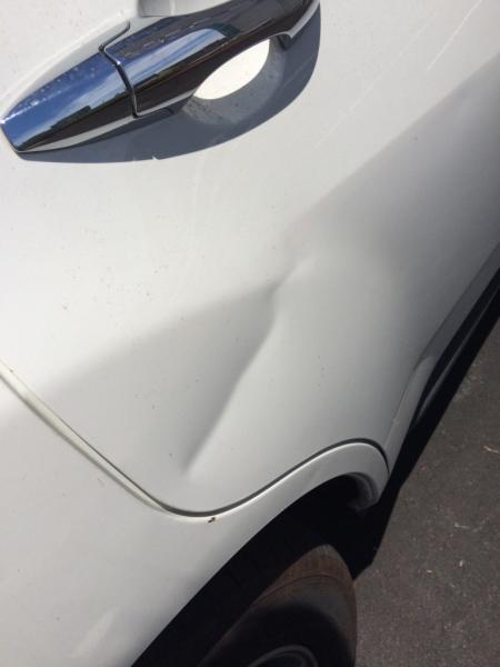

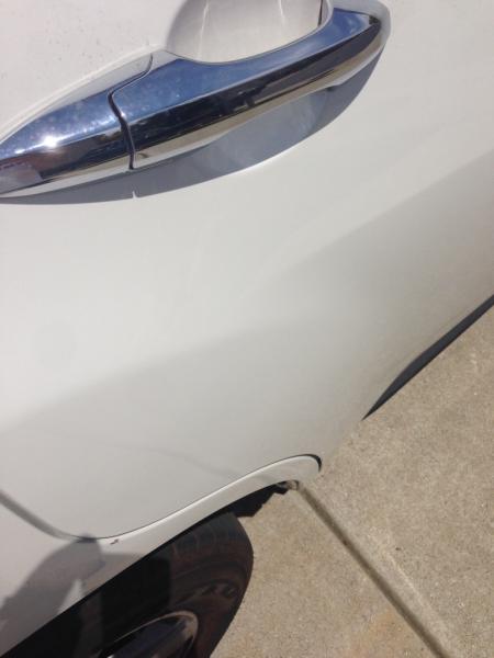

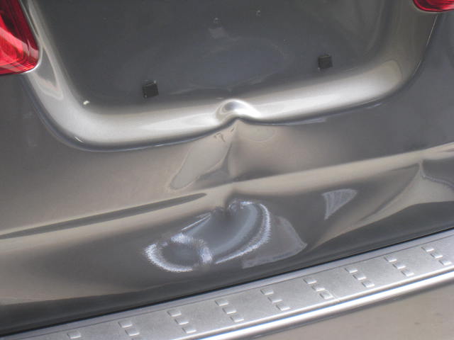

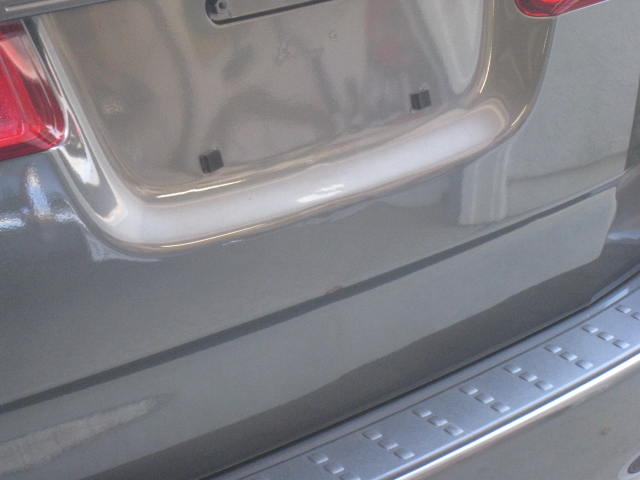

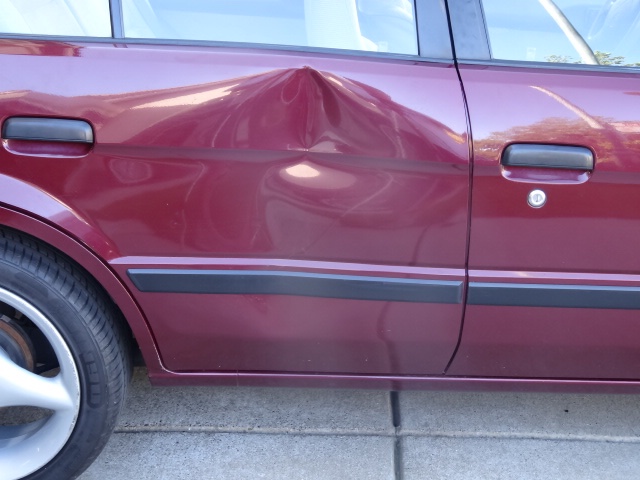

OK, back to creases. Creases come in many forms. Short, long, straight, curved, S-shaped etc. Through flat panels, curved or my favorite, a body line.
Here's a couple examples of creases, one through a bodyline, one about 2/3 of the door.

Impressive work...of course if I were trying to vet some local PDR guy based on pictures, I would want to be sure I'm not looking at his photoshop skills.
Impressive work...of course if I were trying to vet some local PDR guy based on pictures, I would want to be sure I'm not looking a his photoshop skills.
Or, he found some dentless cars, photographed them, then applied dents, and photographed again.
AUSMHLY

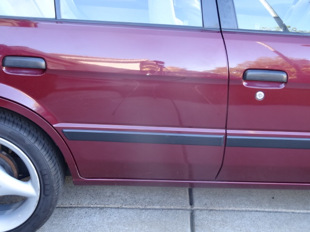

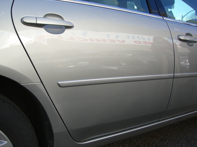

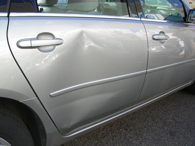

Man, sooooo busted. Yup, took a photo of the door before the dent, kicked a dent or crease in, then photoshopped it to make it look even worse. Surprised no one mentioned that I also leave my business card too. Got dents?
