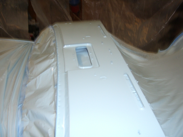

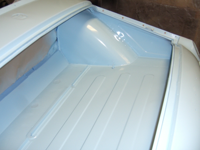

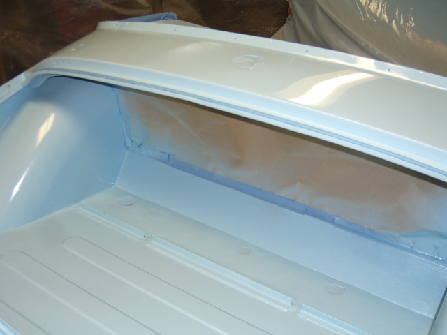

Well the more I color sand this last painting the more it looks crud from all the forest fires we were having around because most the crud is on the horizontal panels. Our air was actually worst that Beijing. I was inside with one door open; plus I had visqueen up and canvas on the floor. Anyways my question is what is done in last half hour before painting? I basically wiped everything down with solvent and the waited an hour and painted. Now I am thinking I should have wiped down with a dry rage moments before shooting. It looks like I can fix this paint and the orange peal is very slight and in many places not at all.

You may want to wipe it down with a tacky rag before you paint. You can get them at the Auto big box stores.
The smoke and crud must be bad if it is like Beijing.
David
Glad to hear it’s looking better. It looks wonderful in the pics! You’ll be spraying perfectly by the time you get to the last panel.
The tack rag right before the spray is the text book solution. It’s a cheese cloth with a waxy coating that attracts dust.
My usual pre-spray routine is to go over the entire surface with a blue paper towel dampened with laquer thinner. The blue towels don’t leave little threads like rags or white paper towels. Micro-fiber rags would probably be even better. I do not scrub with the thinner, as if you use too much or use too much force it will soften the primer and make a mess. I wipe in only one direction, one wipe over each area...just to remove the surface dust.
Once the thinner dries, I go over the surface immediately before the spray using a clean latex glove...again, only one direction and just to remove the dust that has accumulated since the laquer wipe. If I have remembered to get a tack rag, I use it for this final wipe...but I usually don’t have a fresh tack rag and just use a glove.
Yes the air was thick with dust like I have never seen; heck Mount St Helens at least on the West side when she blew did not give this much smoke out. I am such a bullet head that I never gave it a thought and just waited for the solvent to dry because I had everything inside. Most the things I have learned have been the hard way. I usually have to hit myself with a hammer in the hand before I am running on both cylinders. I was afraid to use lacquer thinner because like John suggest it could soften thing up. Perhaps with more experience I will have the confidence to use it. We should have 3 to 5 weeks of warm weather to get this painting done; I am optimistic. The paint laid down so well this time that I found a dent between the gas cap and the trunk hinge that I swore was not there. It was small but deep and the high gloss made it really pop.
Just to make you feel better, I had to paint my TR3 3 times. Stuff kept falling in the paint, I put too many drips, etc. I decided that without a paint booth, you have to create something to keep the outside particles off the wet paint. I set up a plastic booth that has a 2 foot hole at the floor on one side with a high quality heater filter on it. The other side has a 5 foot square filter area with a big fan sucking from the outside. This causes all the particles and left over paint to stick to the large filter on it way to the exit. This works ok. I can only paint about 3 fenders at a time, or something happens and I mess up.
PS: I put zip wall zippers on the front corners of the plastic to keep it closed, allow the car parts in and out and let me in and out. I have a hood with pumped HEPA filtered air to breath in the room. So far I have painted 3 cars and not seen an improvement in my painting, but I am much better and sanding and polish!
Jerry
We’ve been getting a lot of the smoke all the way over Texas the last few weeks. You’re right, it seems there is always something to mess up our work. Before I die I hope to build a good shop with a paint booth to reduce the number of things which can go wrong.
