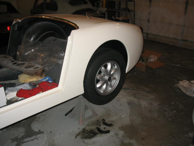

Solid colors look better in single stage. I'm not fond of two stage for solids. It makes the color look like plastic not a fine rich color. An outer skin paint job should be able to be accomplished with a gallon of unreduced color. Some paints and paint brands have less solids than others. Hence the need for more product in some cases.

"I'm not fond of two stage for solids. It makes the color look like plastic not a fine rich color."
... It is truely a matter of personal preference. I like two stage for darker colors, but I think lighter colors look better as aingle stage.
I am a clear coat lover, looks like a first class wax job without the effort. Old men love clear coat.
The trick is to mix a little clear into the final coat of color on a single stage job. This gives you the added UV protection, extra durability and easy chip repair but doesnt add as much shine. The single stage paint will shine but the color will be on the surface instead of being buried under the clear.
I like BC/CC on cars that had it originally don't get me wrong, as you said its personal preference.
