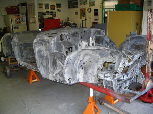

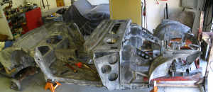

Scott, there is another alternative. From the welder send your frame to a metal finisher (acid dipped). Actually I have my frame "dipped" prior to welding on new panels etc. Nice to have clean metal that is rust proofed from the dipper. From what you're telling me, the cost would be about half of what blasting would be.

I've got to say that I would be wary of "dippng" the chassis. There are so many confined spaces, overlaps, etc. that the possibility of trapping corrosive liquids, even in small amounts, would be too great. I'd go for media blasting of the chassis, which is the route I took. $1500.00 sounds a bit high. It cost me $450.00 for the blasting, and a total of $1000.00 for a complete prime, seam seal and final color.
The major problem with dipping is that it removes any protection on inner
surfaces that you can't get spray paint to hit. Not sure of Healey frames
but a lot of frames are dipped in a protective solution that coats the inner surfaces. If you remove it, the frame rusts from the inside out and you won't know it. I had a hood dipped once and had problems with the seams rusting. There are places that will dip a frame in paint or other coating after chemical stripping.
I agree, $1500 seems quite high. I have had three sandblasted and know others that have had blasting done and $4-500 seems right. If you were in northeast Ohio I could give you someone who did my last one for $150. Also agree about dipping doing too good of a job, especially on the inside of the frame rails.
