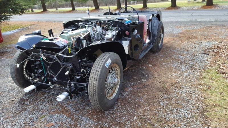

My body panels are epoxy primed only, no paint yet. See attached pic. I've driven it around the neighborhood...right past the sheriff and judge's houses! I did add air ducts to both sides after taking this pic.
The plan
1) paint all body panels
2) hang them
3) Install interior
I think I will leave the interior in the dining room That way my wife will motivate me daily to get it installed. :wink-new:
