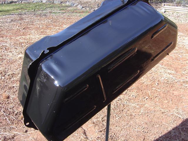

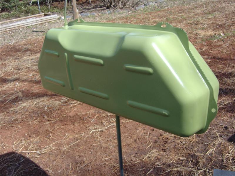

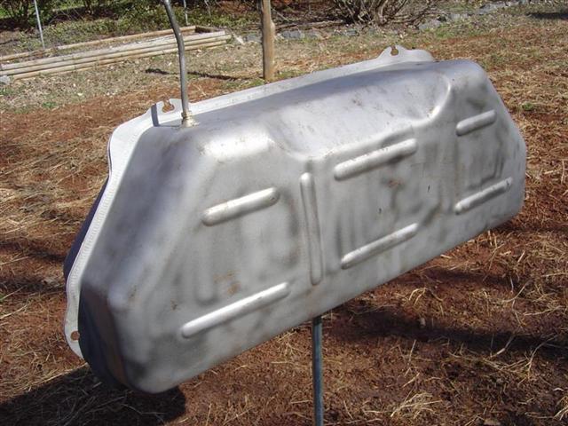

So now the gas tank get blasted inside and out and painted, the rust came out quite well with the sand blaster and then vacuum out the sand

How difficult was it to sandblast the inside of the tank? Did you use the filler opening or did you remove part of the tank's sheetmetal to gain additional access? Did you use any etching acid beside sandblasing to insure entire tank had a surface for the sealer to grab?
The tank appears to be exellent which appears consistent with all your other work!!!!!
I just stuck the sand blaster nozzel and hose inside the tank thru the sending unit opening and kept moving it around, twisting moving, tilting, well you get the pic. I would blast till I ran out of sand, 50 pound bag, vacuum the tank out and do it again, I did that 3 times. From what I could see it got all the rust which was mainly surface rust, no holes. And then sealed with the POR 15 tank sealer, I didnt etch it either.
Hondo
I don't think that you would have needed to etch it after all of that blasting as long as you hit all of the smooth and shiny areas of the tank. The blasting will give it a surface to grip.
Great job by the way!!
