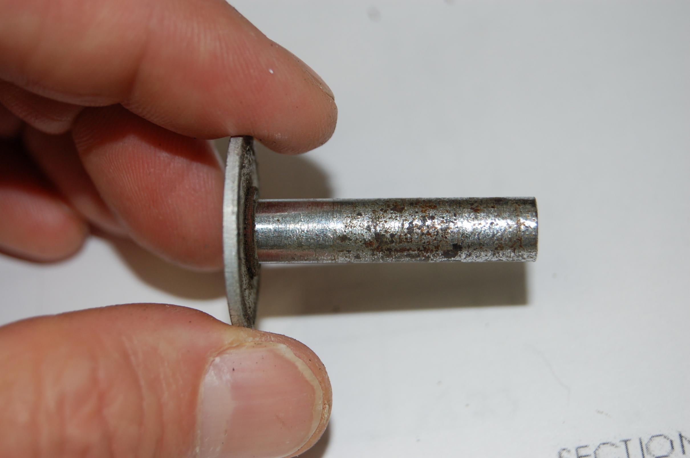

Randy- out of curiosity, does the bezel nut in your pics have a large chamfer on the outward face around where the shaft comes through or is it a trick of the light? There appear to be two styles because the hole in my dash is too small to fit the dimensions I got off your bezel a while ago. I also found an original pump in an Austin sedan earlier this year and it has a flat face.

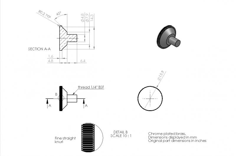

I estimated dimensions from Randy's pics and made this one, which I'm now certain the bezel isn't correct for most BN4s.
A few months back I found a washer pump in a rusted out Austin A55 sedan which has what I believe is the same bezel as Longbridge BN4. The difference to BN6/later BN4 is the hole in the dash is smaller and the outward face is flat rather than bevelled inwards.
The knob is a best-guess dimensions off Randy's pics. I haven't found anyone willing to actually measure one yet.
I'm pretty sure you could modify a later pump to look almost identical to the original with a bit of machining skill.
Andy.
Andy, I have a spare longbridge dashboard and it has the pump in the dash (although it is seized solid) and it has that dished faced bezel on it. No knob though. I am slowly trying to extract it from the dash without too much damage so I can attempt to either restore it or do a MOD like Randy did.

Did you ever ask me to measure mine, because I don't remember *not* doing it for you. I'd have to pull it out of the dash to get the most accurate dimensions, thread pitch, etc., but eventually I could get it done.
OK Randy... I'm asking. I could use the measurements to make a repro knob for our pump. If you have the time that is. On a related note, did you ever come up with those Rover caps to see if they fit the original bottles?

Randy- I think you were still moving when I asked for some measurements and I completely forgot about it when I was over your way. Scary to think it is twelve days shy of a year since I was at your place.
It'd be interesting to find where the change point is between the two styles of washer pump bezel. Healelyblue- any idea of when the car the dash belonged to was produced?

I have no idea. It was a loose dash I got in a bunch of parts with two cars. Neither were longbridges but this dash definitely is.

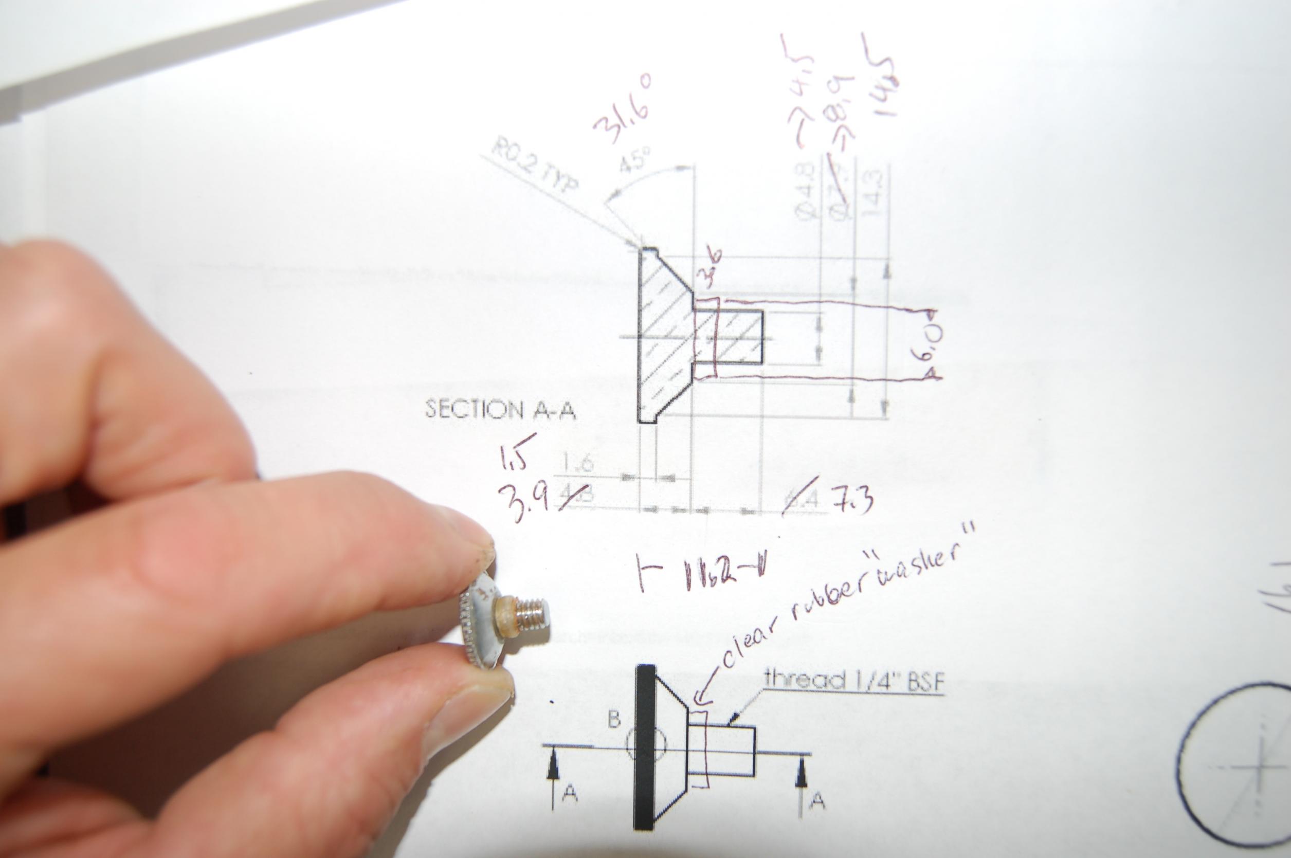

Andy,
I just measured mine and took some photos...

Thanks Rich. I'll make a second drawing based on your dims. When was your car produced?
This is the same pump as the one I have out of the sedan which is the earlier style. Pic is on Derek's site
