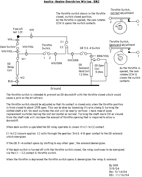

Addendum: I recall that my first BN2, in 1964 (when I was 18) had a centrifugal switch in the OD circuit, which would, in combination with the throttle position switch, allow the dashboard switch to be turned off and the OD to still be engaged. When the throttle was pressed the OD would disengage automatically and the effect was like a really quick downshift. The centrifugal switch also prevented the OD from engaging at a low speed. My current OD has a cast boss but was not machined for the switch. Does anyone know the history of the change?
Re: Overdrive solenoid--How do I diagnose weakness
Actually it was the BN1 that had the centrifugal switch plus two control relays. The BN2 was simplified to eliminate the extra "stuff". Your car should not down shift when the dash switch is turned "off", unless the throttle is partially opened. I have attached a schematic of the BN2 overdrive portion of the wiring.
D
