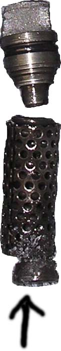

I found a pic of the part which fell into my drain pan...it's the top part with the silver filter screen. I reinserted it with the narrowest end at the top; it wouldn't fit the other way with the screen up. The other piece is either still in the OD or gone forever.
The pic is attached to this post...

Yeow , that is a nasty valve. Was there any trash in the screen? Clean what you have there before you put it back. Anyway , at the top of the valve (bottom of the image near the arrow) should be a spring loaded check ball. See if it is there and will move with slight pressure. I'll see if I can send you an image of the factory parts book diagram.
Thanks, AlanT...that wasn't my own valve in the pic. It was just a pic of one I found to use for an example. My valve was pretty clean when I found it; the only piece I found was the top one in the pic, the one with the screen. The bottom piece with all the vent holes was nowhere to be found.
