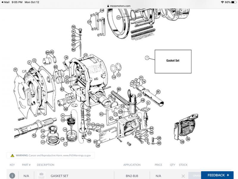

I think ??? Roscoe is referring to the “non return valve “ which is screwed into the side of the pump body .see Moss drawing items 100to 105ish

I'm referring to the pressure relief valve ( called the pump valvemin the manual) that is at the base of the OD oil pump. The spring loaded ball bearing keeps the port closed until the pump reaches operating pressure and then pops opened for very brief intervals to regulate the pump output pressure to the range of normal operation ( more than 400 psi). The pump would put out more pressure, possibly to the point of damaging itself if the relief valve were stuck shut and if it doesn't properly close, it allows pumped oil back into the resevoir at the bottom of the engine and proper pressure won't build.
Oops. I hate spreading misinformation. Bob is correct. What I have been thinking was the pressure relief valve is in fact a one way check valve. The pressure relief takes place in the accumulator section. I got that into my head when I corrected a lack pressure by dressing the seat for what is referred to as the pump valve. If this check valve has a significant leak, it may not allow operating pressure to build as was the issue for me. Sorry for the confusion.
No problemo, Roscoe (I've been a superspreader of misinformation on occasion). I've been both fascinated and perplexed about the OD operation for years; it took me a while, staring at the OD in pieces on the bench, to understand its working (and I may still have it somewhat wrong). I never understood why there wasn't a pressure release mechanism--it was never explained in any of the literature I read--until I pulled the accumulator sleeve out and had an 'Aha!' moment.
