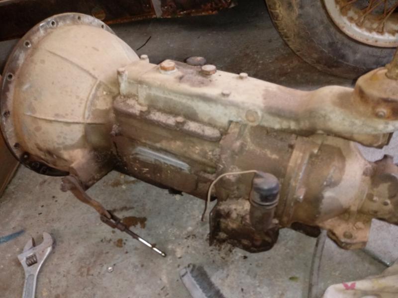

What is the black piece just above the narrow band on the plunger?

That black piece is the rubber dust cover, I left it off tends to restrict the plunger

That's a rubber boot, to help keep dirt and water out of the solenoid. Normally supplied with the solenoid, you can see a little better view here
