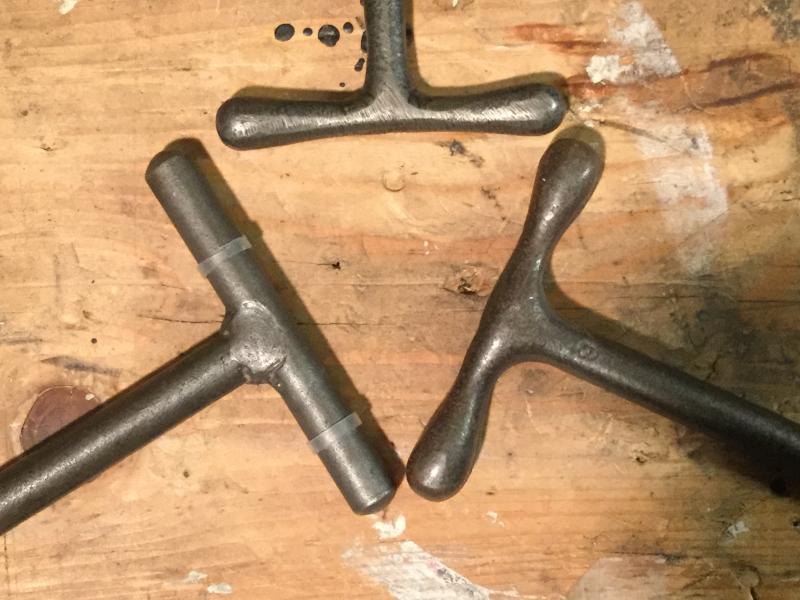

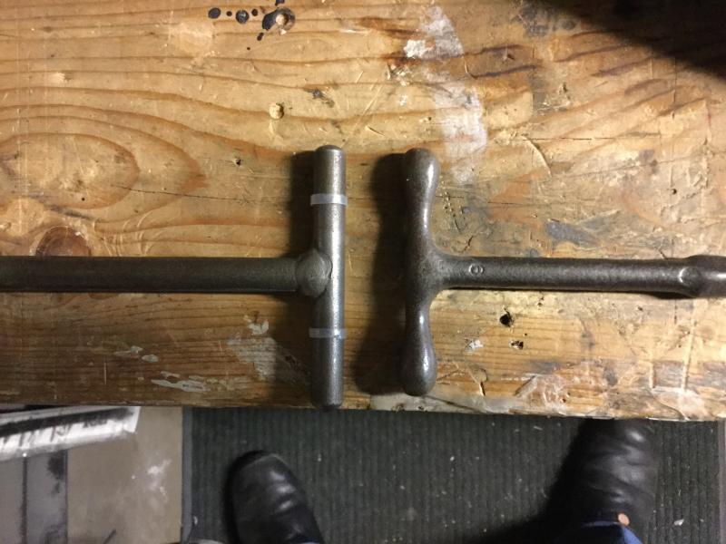

Here's a pic of three keys.
The lower left is a spare I got from TRF.
The top is a spare someone gave me.
The lower right is one that came with my 3, and dates to at least 1984.
So the "correct" one is the TRF key? Hmmph...

Great...thanks to all of you for the pics and info!
Kevin, your reaction was just like mine after I read the guide...but I guess the TRF style in your pic is correct.

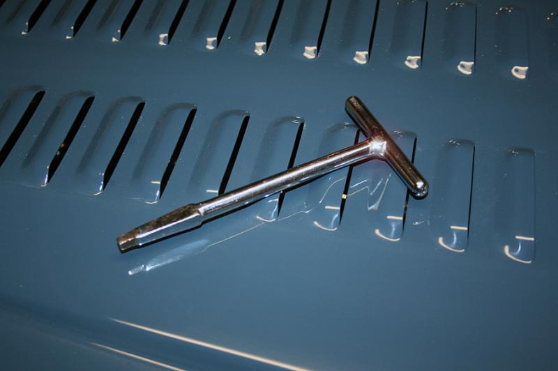

Hi John the original is 6 inch long and 3/8 di and says nothing on the casting. The bottom piece looks like it is cast because of the bottom being bigger and a seam running down the round side, but not on squared off tapper end. Note the little notch at the last; they are heavy also perhaps harder steel
steve

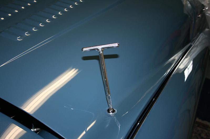

My first post....Factory chromed "T" key, used on the TR's at the New York International Automobile Show,
at the New York Coliseum 1958 or 1959.
Cheers,
Colin

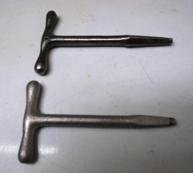

Here is a photo of the original coach key that came new with my 1958 TR3A (TS 27489 LO) at the bottom. The square end is square and parallel to the handle. Notice the upper key. The square end is cast as a diamond. This key is one of several that I purchased since 1990. The angled square end is probably to facilitate the casting process steps by providing a draft angle to the mold.
So Don - It appears that the TRA Judging Guidelines would cite your original coach key as incorrect:

Thanks again for all the responses! I'm glad to see I had reason to be a bit confused. Don, once again, shows us the Judging guide is off. But, until it gets changed I'll start looking for a key like in Colin's, Steve's, Kevin's and Randall's pics. It is interesting that the originals have the flats parallel to the handle, while most of the repros are at 45 degrees.
