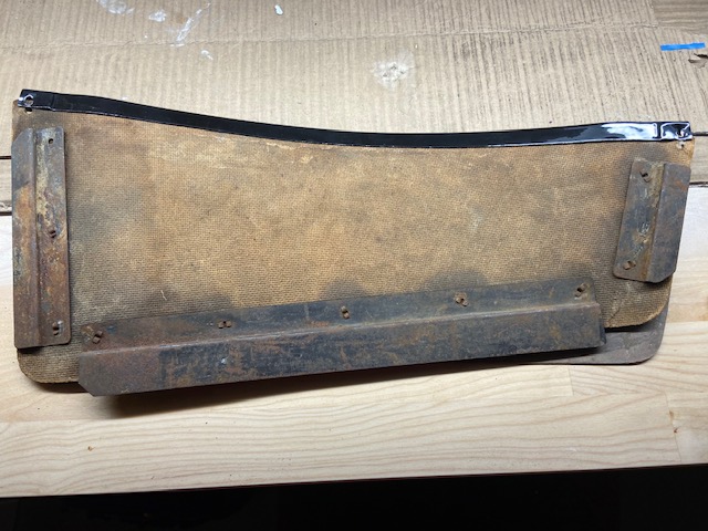

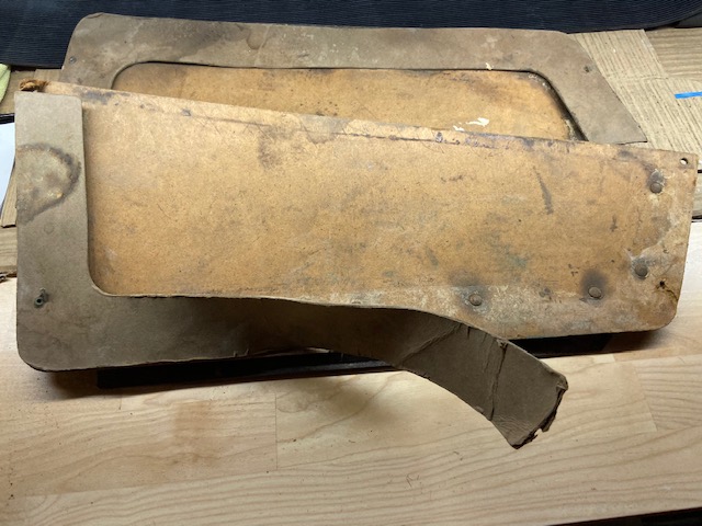

I am preparing to re-do the door pockets in my 60 BE.
I have had the car for many decades just getting the restoration completed. I of course did not take photos nor can I locate my notes of the condition of the door pockets when I removed them.
As you can see from the photos these are the original pocket panel doors. Original fiber type board with cardboard attached for the material to capture the "indent".
What I can't recall is how the metal supports on top of the pocket doors fit. As you can see I had them powder coated thinking they fit over the black door skin material onto the board. I have seen photos of newer restored cars that appear to have the material
go over the metal support such that it is not seen.
Does anyone have an original BE who can inform how the fit is? Or have knowledge of how it fit in original cars?
I will keep and repair these panels and I'd like to have them fitted as original.

What you show in picture 2 is correct, the metal frame sits on the fiber board and the vinyl goes over the metal.
Mine are restored originals.

Thanks Desert Rat,
Your photo refreshes my recollection on the mounting, how far down the other side does the material extend if at all?
I was thinking of painting the backside black but it looks like there was no paint on my originals.
If it extends to the back it must have been cut to fit the metal sliders?
Thanks so much.
Desert Rat
How it left the factory I couldn’t tell you, mine were so dried out and shrunk up it was hard to tell. My vinyl came pre-cut in the interior kit from AH Spares and extends pretty far down the back with the sides and bottom trimmed around the metal brackets.

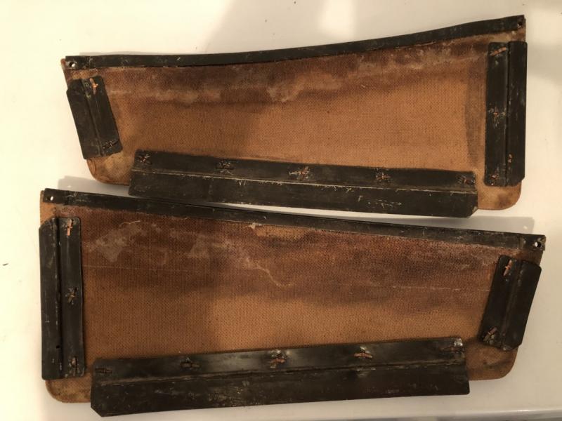

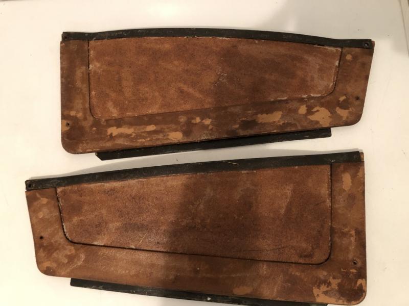

I'm sending my Bugeye to "Bugeyeguy" this spring 2021 - I'm having him redo my interior and I just took my pocket doors out a few weeks ago....Here is a pic of what the original door pockets would look like without the vinyl. Not sure if this is what your looking for or if this will help you out. Take a look.
T
tiiM5
Dug, Thanks for the pics. Very helpful, those inform as to the original structure. I couldn't recall if the metal bar went on top or under the upholstery. I had mine powder coated out of an abundance of caution. At least they will be a smooth fitting for the material covering on top.
