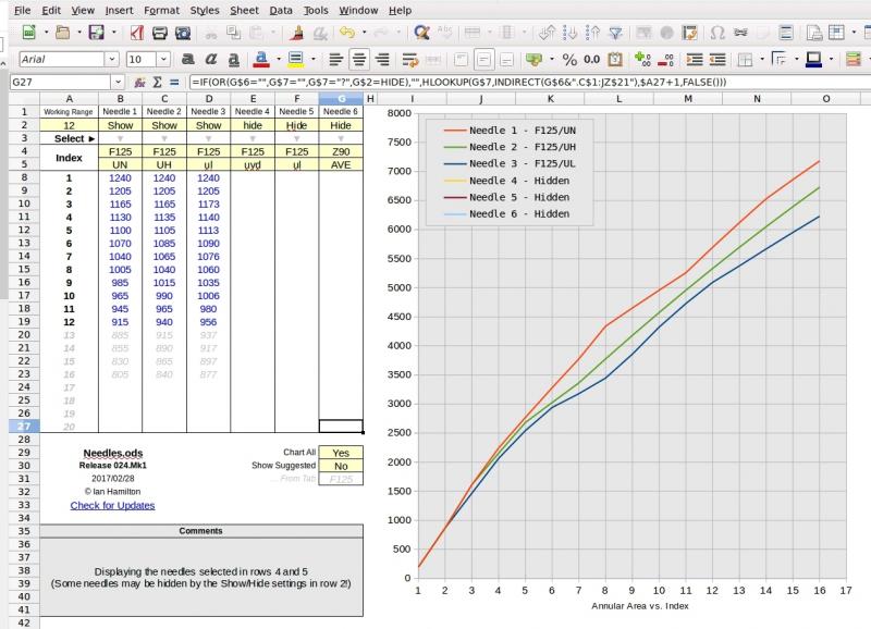

Online SU and Stromberg needle database with comparison charting
steveg
Example - the three HD8 needles:
See below for downloading instructions.
steveg
steveg
This should be a perma-link:
https://mk1-performance-conversions.co.uk/technical_carb.htm
To save the file: on illustration at top of page, right click PC or ctrl-click Mac to download the zip file.
The database, "Needles.025.Mk1.ods" will open in OpenOffice Calc. There is an option of downloading a free program (LibreOffice) to run the file.
A pdf ReadMe file is also extracted from the Zip file.

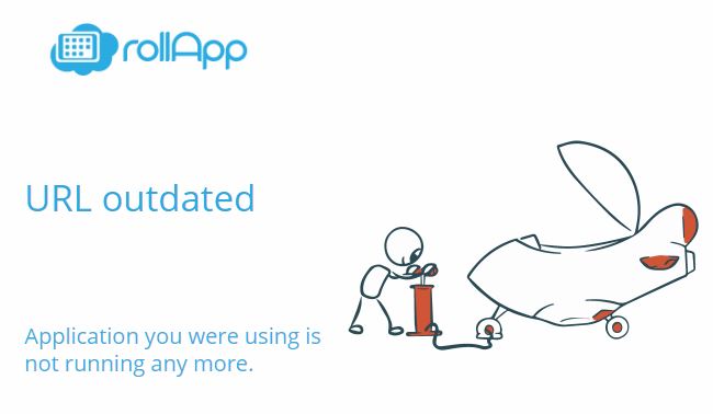

Addendum - Just found online link:
https://sucarb.co.uk/needle-comparison
On the resulting page, click "Click here to open". To enter your needles, you may need to click the button "Edit Document" in upper right .
