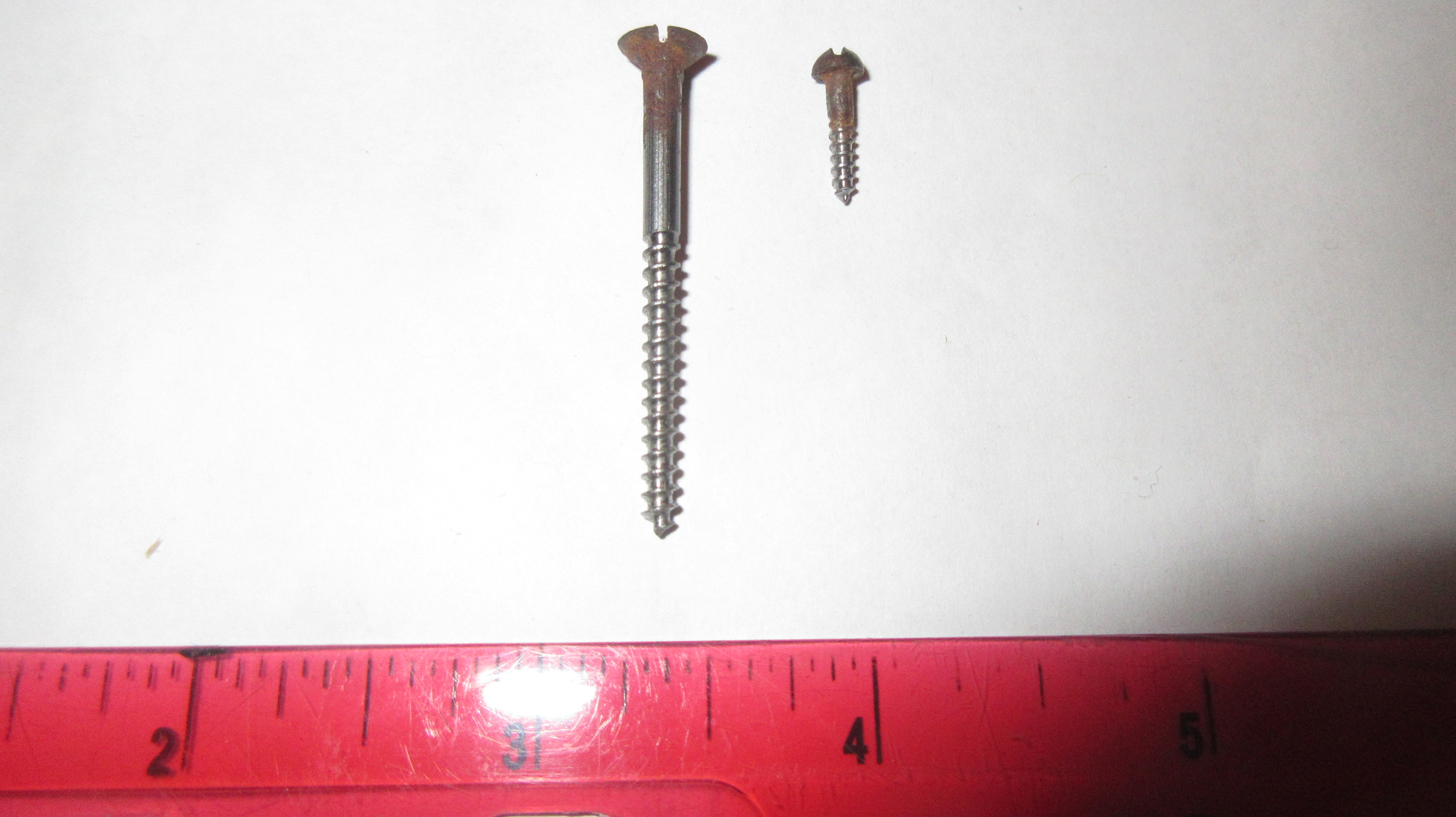

How the heck do you remove those old single slot screws??? None of my screwdrivers fit - keep twisting out of the slot. Screwdriver blades won't even go all the way to the bottom of the slot. Never experienced this before.

Gotta close up picture?
Tom, do you have access to gunsmith's screw drivers? The blades for many of them are hollow ground rather than tapered, allowing them to seat better in some types of screws.
Picture? Vwalah!
The screwdriver blade just barely goes into the slot. It's like the slot is too shallow, or the screwdriver blade "V" is too fat to go all the way into the slot. The screw slots deform easily (ask me how I know ...). Only thing that goes fully into the slot is a mini screwdriver, but that's not strong enough to turn the screw.
Thanks for any help!
Tom M.
Edit: Walt, never saw a gunsmith's screwdriver. Is there any appropriate substitute? Maybe grinding or filing down a standard screwdriver blade somehow?
Thatโ€™s the first thing I would try. Find an old, relatively thick screw drive and grind/file to fit.
Thanks for the suggestions, which I'll try tomorrow. There are over 100 screws, of various sizes. Patience ... I must have patience.

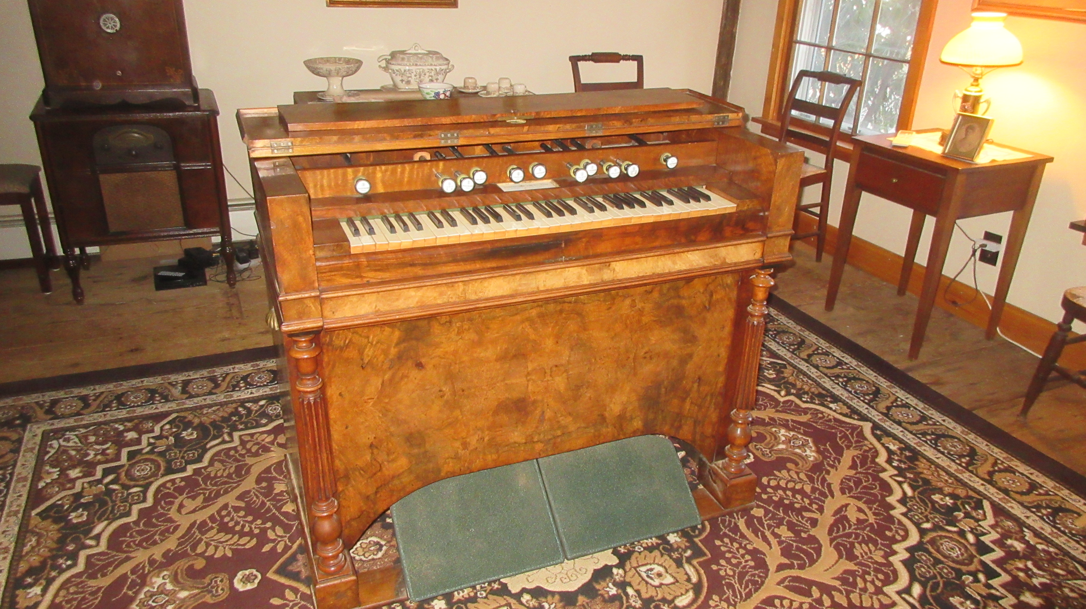

By the way, here's a similar instrument after a complete restoration:
Very different sound, capable of much more expression, compared to the typical nineteenth century American reed organ.
I agree that grinding the head a regular screw driver is likely your best bet.
A bunch of the microscopes I work on have very thin slotted screws.
Use the slowest speed grinder you can get.
High speed heat softens the tool.
Cool in oil.

I bought some old wooden handle screwdrivers from a flea market vendor. Fit all the old screws. Gun screwdrivers will work but might twist under extreme pressure. Kind of like pulling the screws out of the 50s Jags with all those slotted screws rusted in place.
