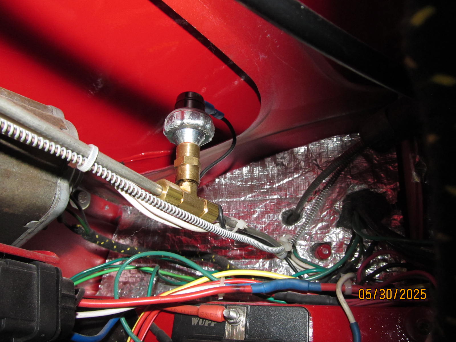

I don't have an answer to the fitting in the block thread size because I installed a pressure switch for my bright idiot light the easy way. I cut the line going to the gauge between the firewall and the gauge and installed a compression fitting T with a 1/8 npt male branch and an 1/8 npt female coupling for the pressure switch. One advantage is it's all accessible if the pressure switch fails - I used to have the tee and switch on the block but when a switch failed, I found out what nasty job it is to change a switch in that location in a fully assembled car, I made the move to under the dash.
Compression tee

Perfect. That's an excellent solution that I'm going to copy for my purpose. I plan to use a Standard Part Oil Pressure Switch PS-064 with power cut-off between 7 and 11 psi. Thank you!

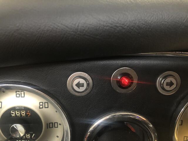

As others have pointed out , waste of time as the engine will run until the fuel lines are dry etc . Here’s my dash set up with a large red LED off an OP switch mounted on my oil filter sandwich plate .
