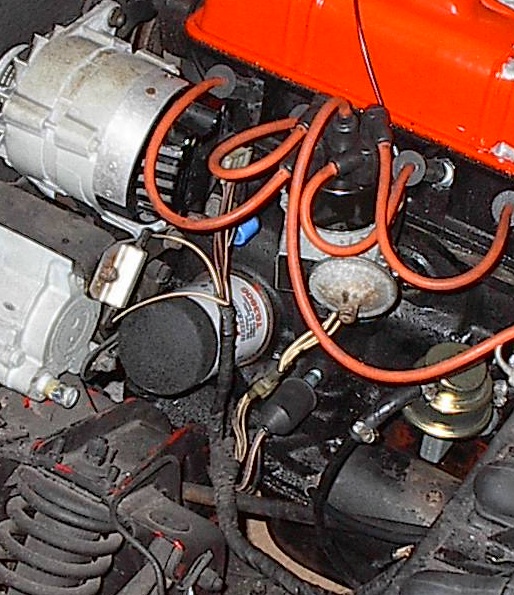

I have been looking for the wiring plug for the oil sending unit. It needs replacing and I do not want to replace the wiring harness now. I have checked several sources and can not seem to find it and I think it has been discussed or at least mentioned here.

Maybe this pic will help. There must be something missing here. Even Lucas systems were not like this.
Looks ok to me unless your talking about covers for the spade connectors. If that is it British wiring has it if your concerned

I think there is usually a 'hood' that slides down the wiring and snugs onto the black base of the OP switch. At least on mine there is. So the spade connectors are not exposed.
I wonder if someone could post a picture of what should be there?
The "hood" makes sense. That would help explain the exposed wires and no evidence of a plastic plug.

I have attached a picture of what's on my Spitfire, I would assume it to be the same on a TR. The OP switch is located just below the distributor. I guess I should have called that rubber cover a "boot" to be more correct. I believe the part number for it is UKC7871.
Also, to answer another post about the TRF part number for a 3-prong switch, there are some variations, so you need to check your commission number. The one for my Spit is GPS113.
