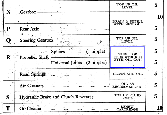

I seem to recall some discussion in the past about the grease gun versus oil gun requirements. The search function didn't cooperate when searching for 'oil gun'. So let me raise the issue again with regard to the guidelines in the manual.

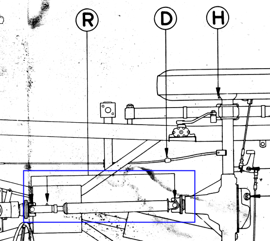

The manual says to use an 'oil gun' to lube the three points on the propeller shaft (R). I've never seen an oil gun that fits a zerk (my experience in the automotive realm is admittedly very limited).
Any suggestions as to how I might properly lube these points with oil? And what type and weight should I use?

Seems to be some debate. The STC manual (you cite) says 'oil'. The TR3A Practical Hints (owners manual) say 'oil' for the U-joint and 'grease' for the splines. The Haynes manual says 'grease' for all 3.

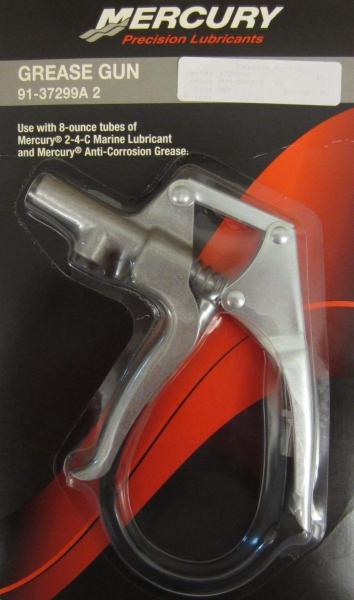

However, if you do want to use oil, there is a Mercury Marine grease gun that is designed to take grease in plastic "toothpaste" tubes. Mercury Marine also sells GL4 gear oil (in a special formulation that is specifically safe for copper) in a "toothpaste tube" that will mate with the grease gun. Not perfect, but it will pump oil through a zerk as long as you hold the gun upside down. Then you have to store it the other way (with the tube hanging down) or it will leak.

Here is the Mercury Marine Grease gun that I use for putting oil into the zerks when the owners manual calls out for oil. 91- 37299A 2 Grease Gun
As mentioned, an 8oz tube of oil will screw right onto the gun.
