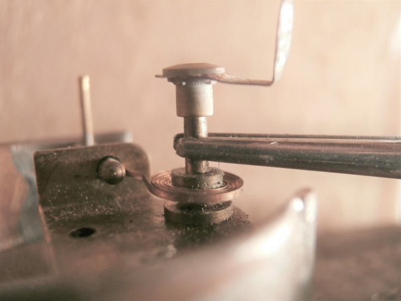

I am working on my oil gauge and the needle was rusty. I tried to sand the rust off with some 400 paper and did ok, but the back has rust also. What I want to is remove the needle, so I have more control and just soak it in lacquer thinner and then sand and paint it. So does the needle just pull straight off? It must? But I do not want to trash the coil spring.

6TTR3A
You may have already figured it out.
It's a push fit, very easy to remove.
See attached.
Remove the works from the case.chuck it up with your vice.
Get a firm grip in the shaft with needle-nosed pliers
The shaft needs to remain steady.
While holding the shaft, pinch and twist the needle with your thumb and forefinger
Off it comes:joyous:
That's the good news.
The bad news is you have to get it back on at the exactly the same spot
in order to have the gauge be correctly calibrated. :blue:

sp53
Now I have a headache or fear ache or playing it too save ----either way ====it is all Franks fault because I know that will work if I am any good, but it still could be rusted on the bottom. Pinch for a reason or just to grab Frank?

sp53
Thanks Frank I could not find the nerve to just go for it, but with your experience I went for it and the needle came right off. I put a mark where it was and if I need more oil pressure I will move the need down some.
I learn a lot working on the speedos also and the little marks they have to set the needle back on in place--- then pull it back to the stop pin for calibration, got to love these cars there is so much that can be done.
