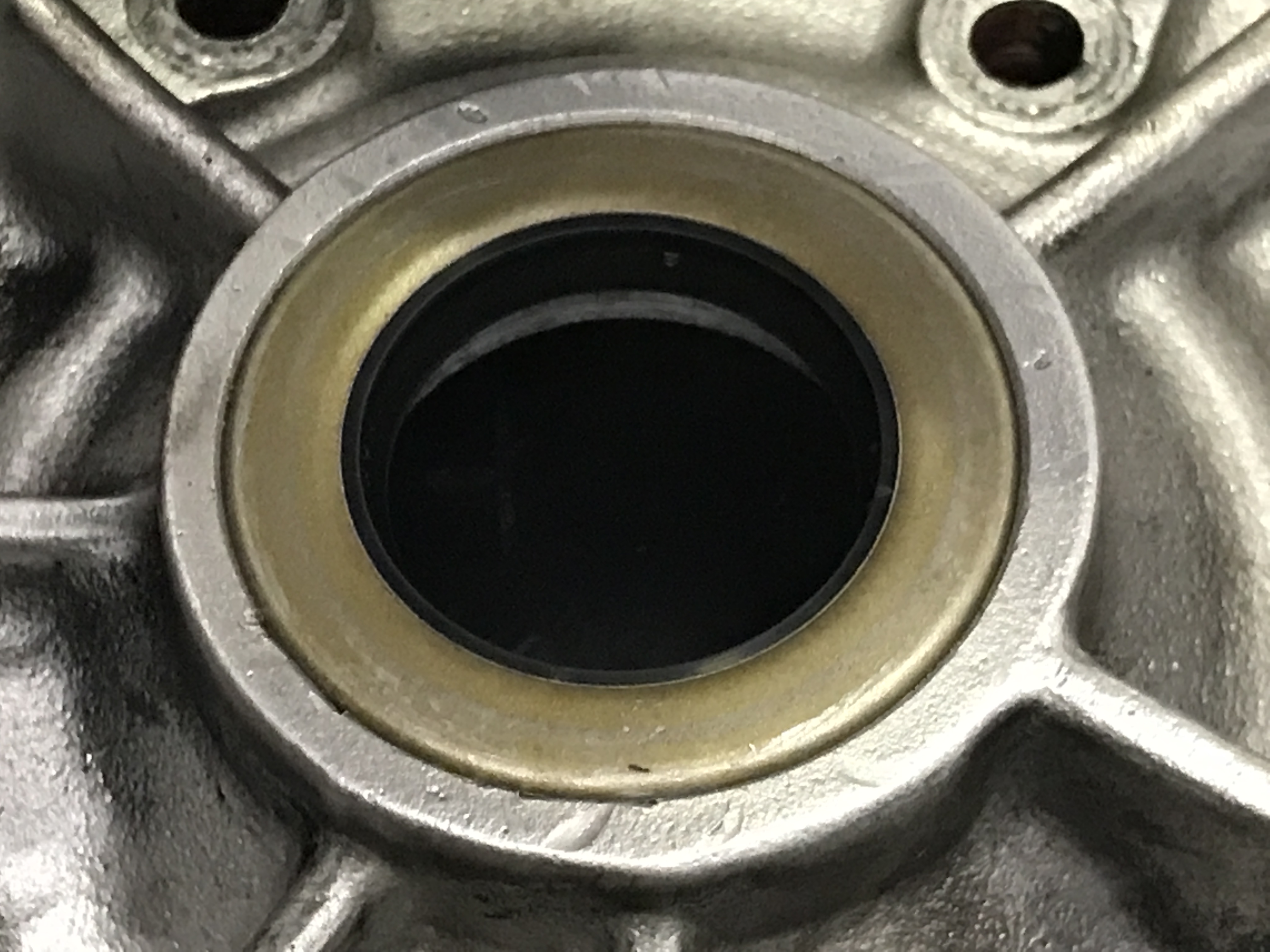

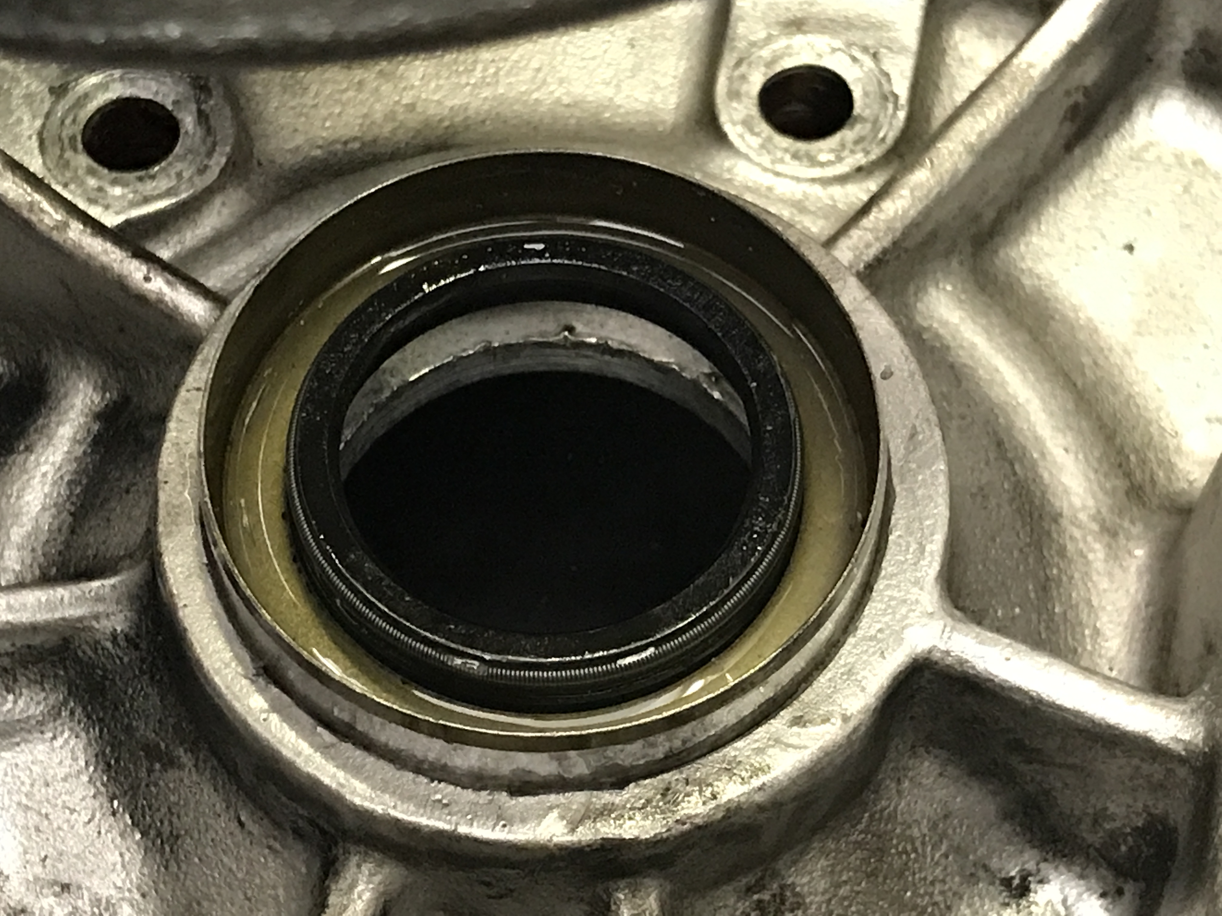

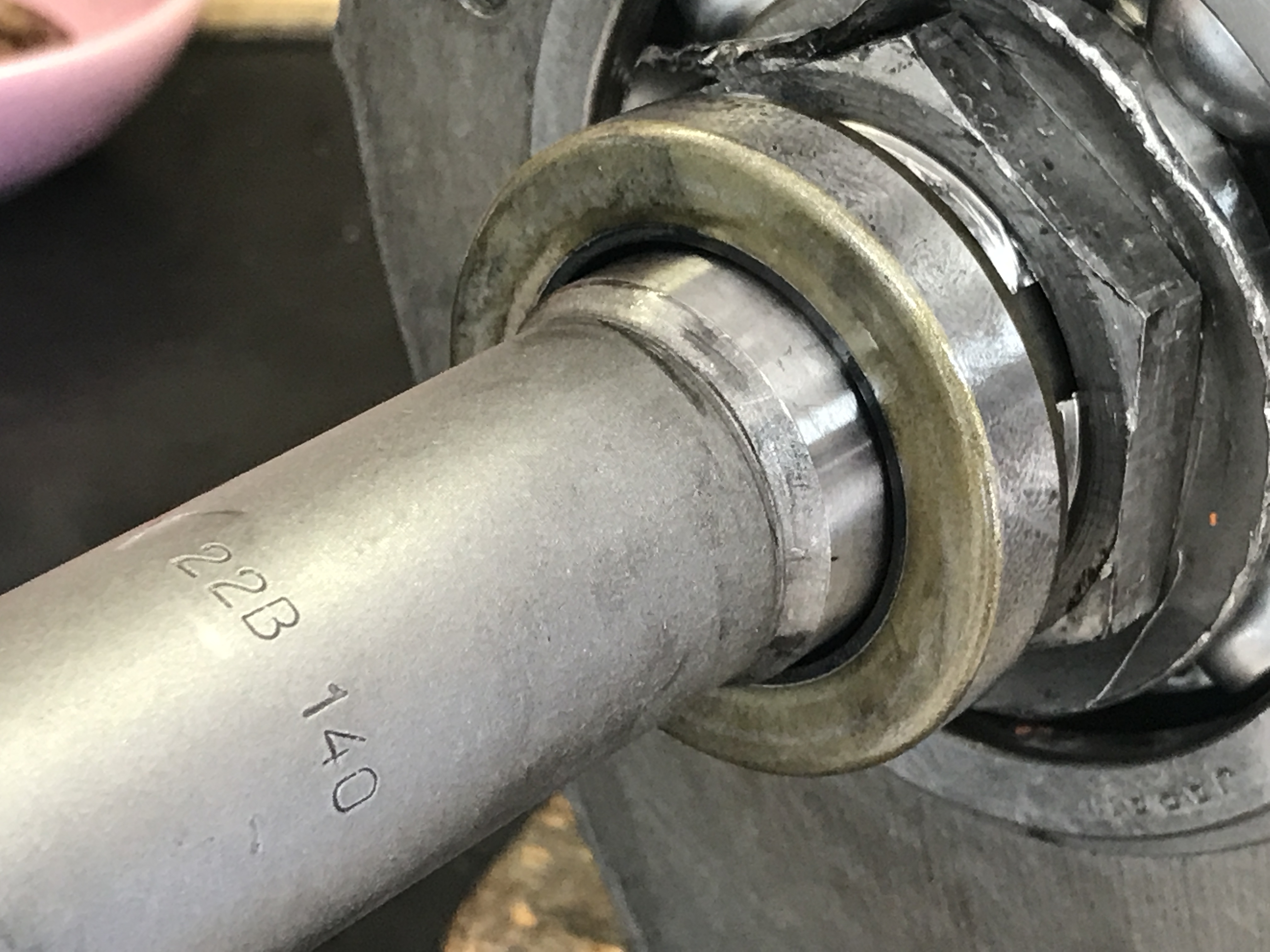

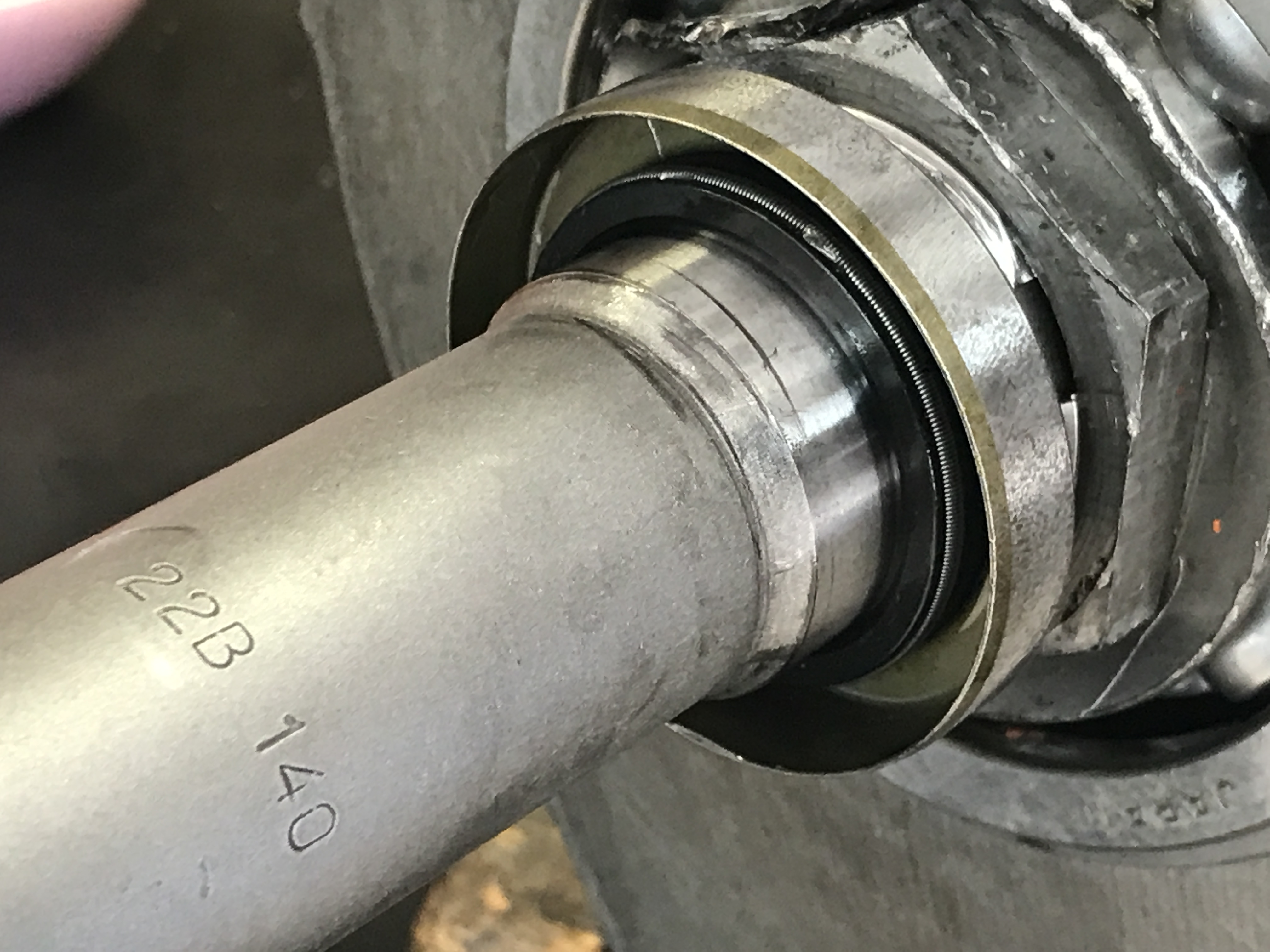

What is the correct way to press the oil seal in the clutch housing?
Flat metal lip towards engine or towards transmission.

As a general rule, the side of the seal with the spring should go towards the fluid you are trying to contain; in this case the metal side should face the rear of the engine (your first two photos). A seal driver is good, but a flush seal can be tapped-in with a (preferably) plastic hammer (even with a driver, sometimes it's easier to start installing the seal with a couple easy taps with a hammer).
If prior seals have worn a groove on the shaft, install the new seal before or after the groove (in worst case, a 'redi-sleeve' may be called-for). An anomaly is the seal on the differential pinion: the differential 'snout' opening is chamfered, and the metal lip should be installed even with the inner, narrowest part of the chamfer.
