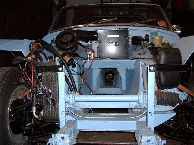

I looked at the usually cast of character's web sites but couldn't find it being sold. This is what I am using and am very happy with it.
Look at the top left of the picture, it is the best shot that I can provide right now.

Nope just at the top of the firewall. They are very snug bak there and the one support seems adequate for the length that I am running.
