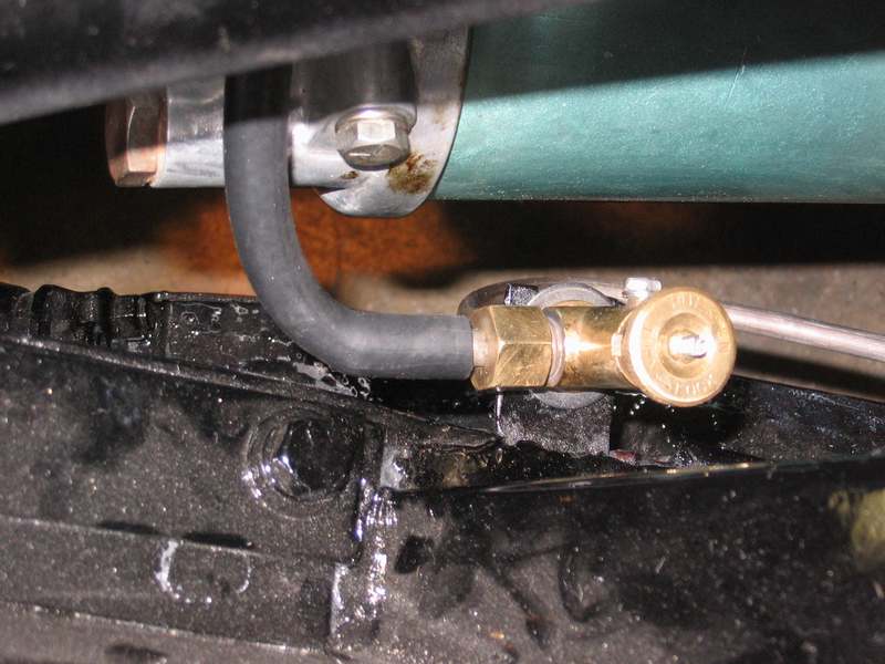

While the cannister is off, why don't you clean it thoroughly and re-spray it "Teal Green" as they were "originally".
