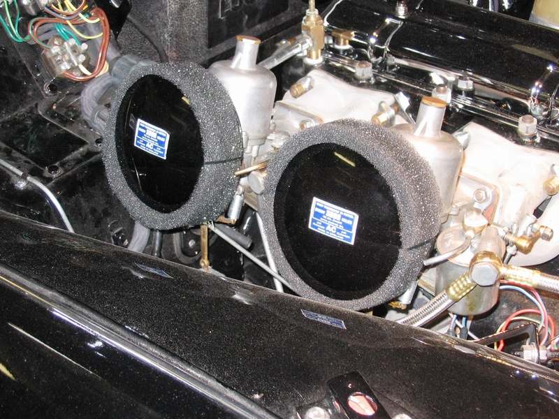

I bought a foam filter at Sears for my industrial vacuum cleaner and cut it into 4 pieces to fit over my original air filters. Then i dribbled on a bit of special Amsoil Oil called "For Foam Filters".
