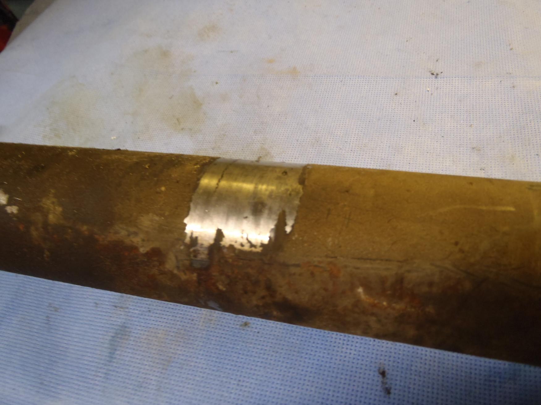

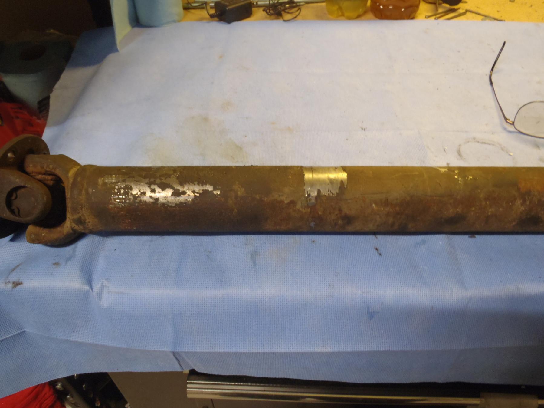

Here are some pics of the old shaft. As you can see there is a worn spot on one side of the shaft (in the area of the tunnel the shaft passes thru). I am no genius but figured how did a rotating shaft wear on one side only?? I is either bent or was flexing severely due to the bad u-jount on the axle end. The u-joint would flex one way easily and hardly at all in the other. Cant wait to try out the new one, hope to get it put in tomorrow....too many setbacks and not enough Oh yea!! One other thing the new shaft feels to be a lot heavier, I did not weigh them but it is obvious from picking them up.

umm.. I'd replace the U-J's on the original.
But that's just me.

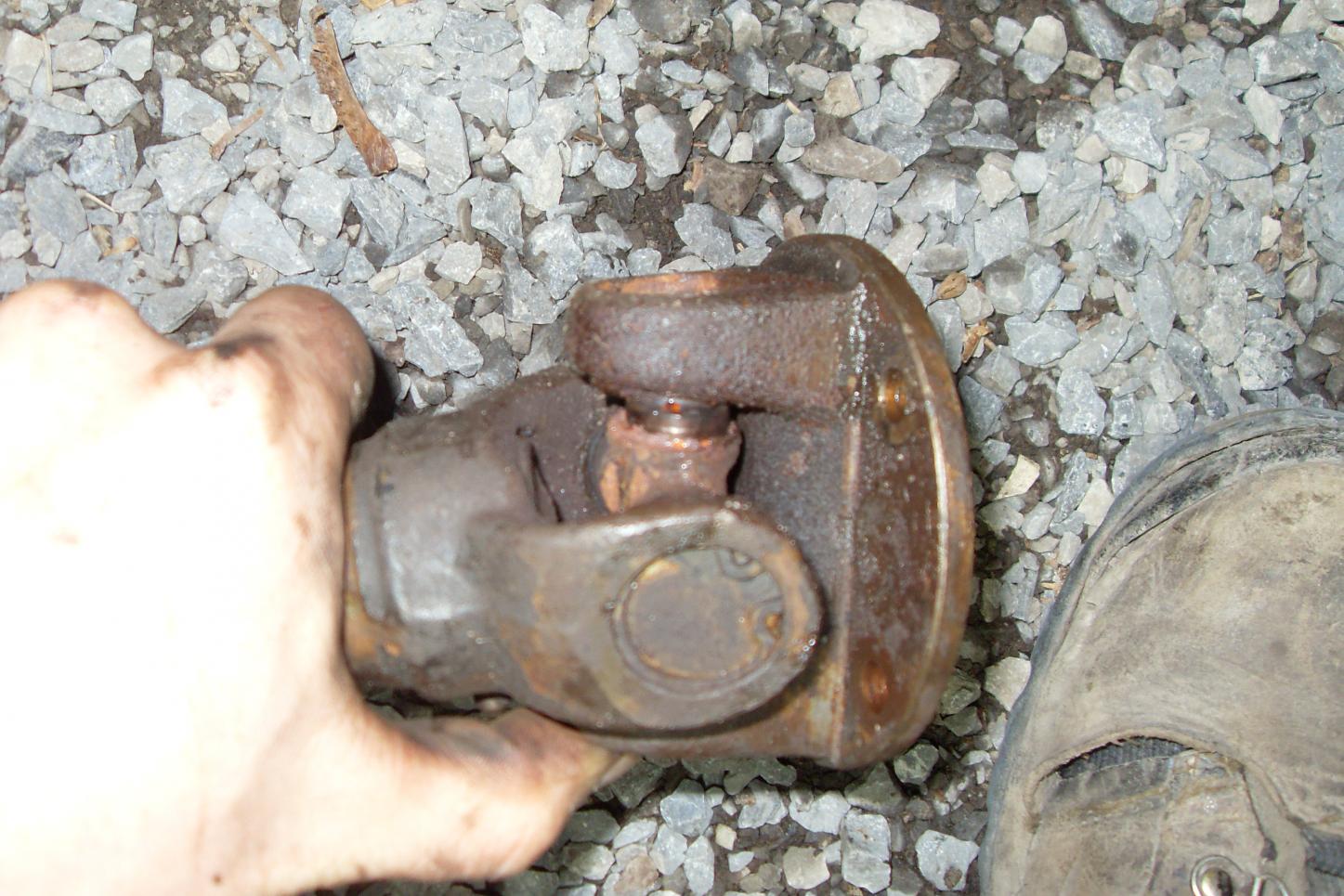

Well curiosity go to me. As much as i didnt want to play with the drive shaft, i wanted to do other things then electrical nightmares so i poked around getting little things in order. putting some graphite in my doors making them smooth like butter. lubing the hand brake, and while i was under there something caught my eye on the driveshaft... two nuts holding it to the transmission where warn from a long time of rubbing. i long was i driving like this? I have never replaced u joints what do the wise ones here say, will that get ride of the play i have?
Put a good straight-edge on the shaft, check it all the way down, in two places 90° around the diameter. If that shows it is not bent, the U-J's can be replaced. If you haven't done this before it can be a challenge. John Twist had a video of him doing this a while ago, he's a bit "ham-fisted" for my taste but he does get the job done.
The job takes a good vise and a BFH with (preferably) a brass drift.
ham fisted... the man got it done in 5 min. haha:hammer: i have no vise. im a bit worried as the small piece that connects to the transmission where the u joint fits in is what looks warn. thursday i should be able to have a 2nd pair of eyes on it. ill check the straightness of it. if you look close in the picture the top most part of the u joint ( there looks to be a red drop on it) thats where the joint starts to be able to slide out of its position it gets worse as you follow that curve to the right. ill see if i can get a better picture and start a new thread as to not get off original topic
