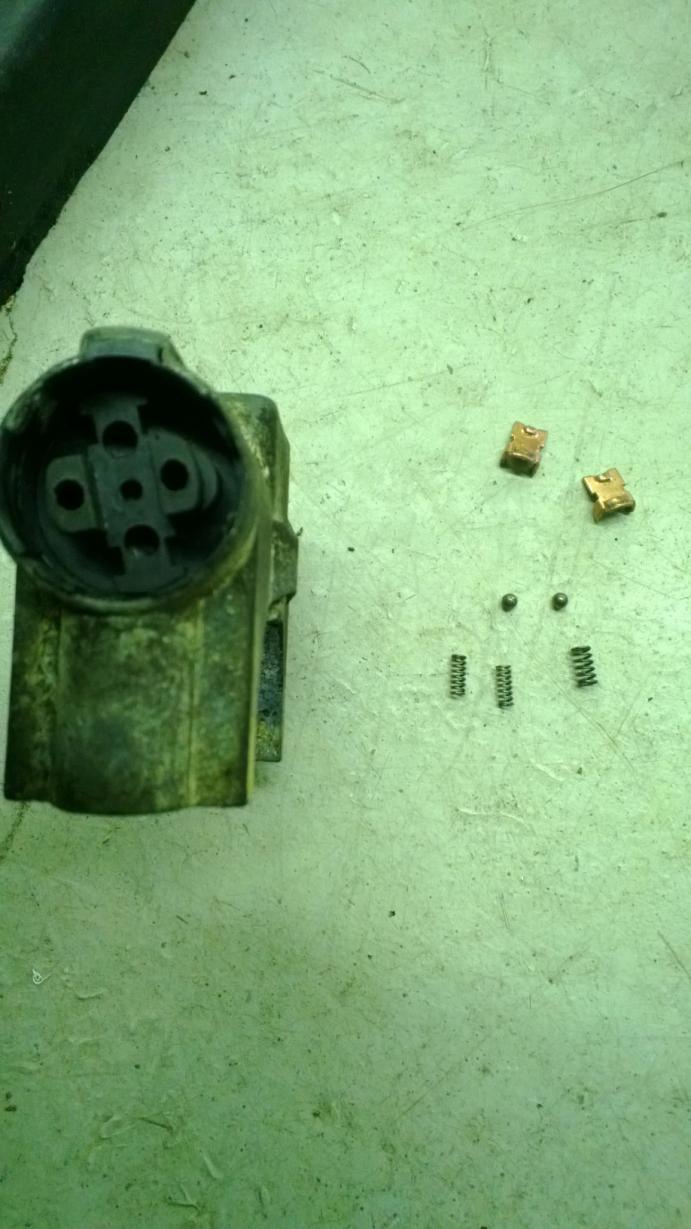

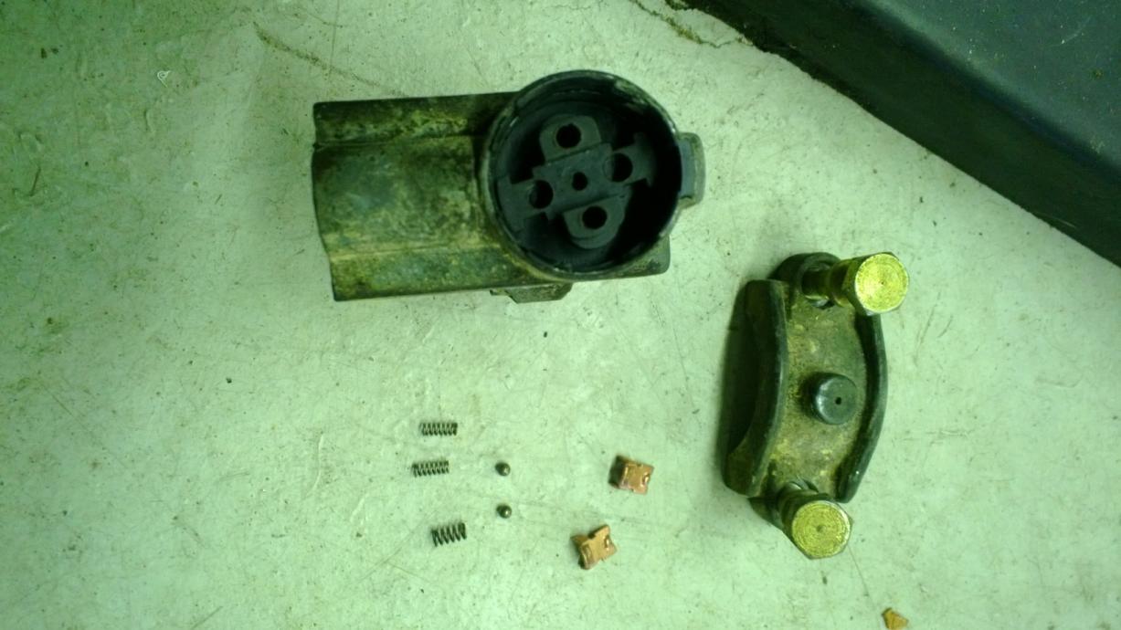

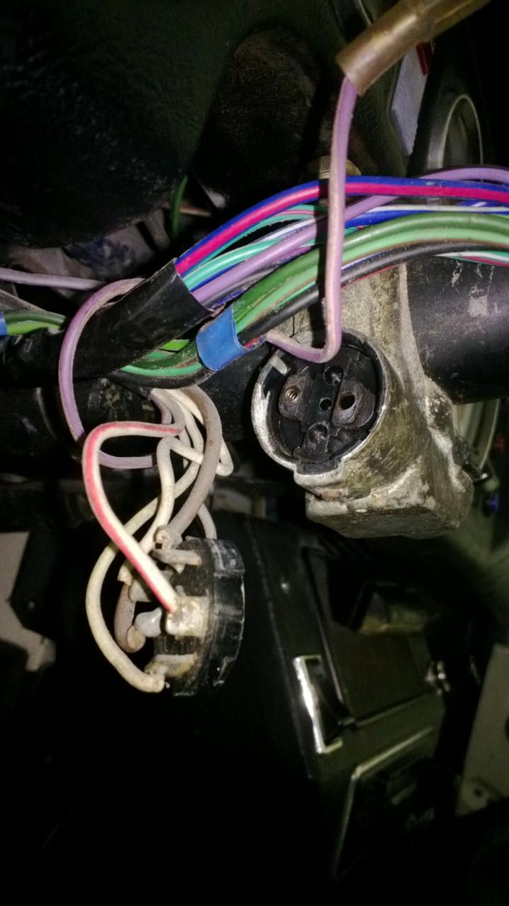

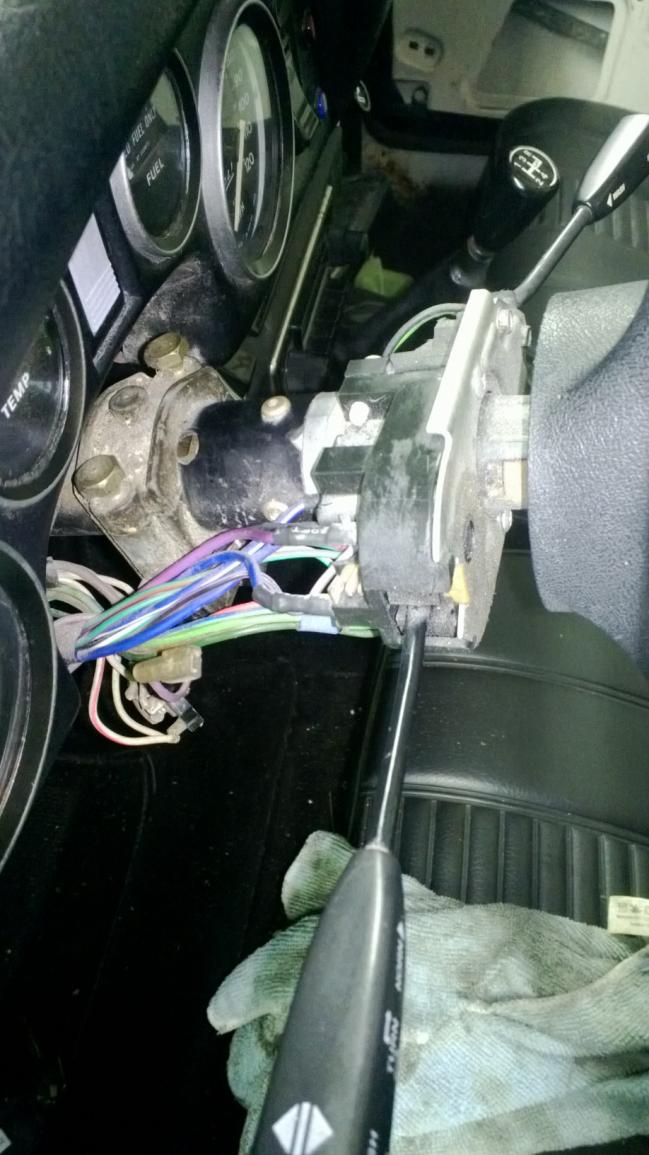

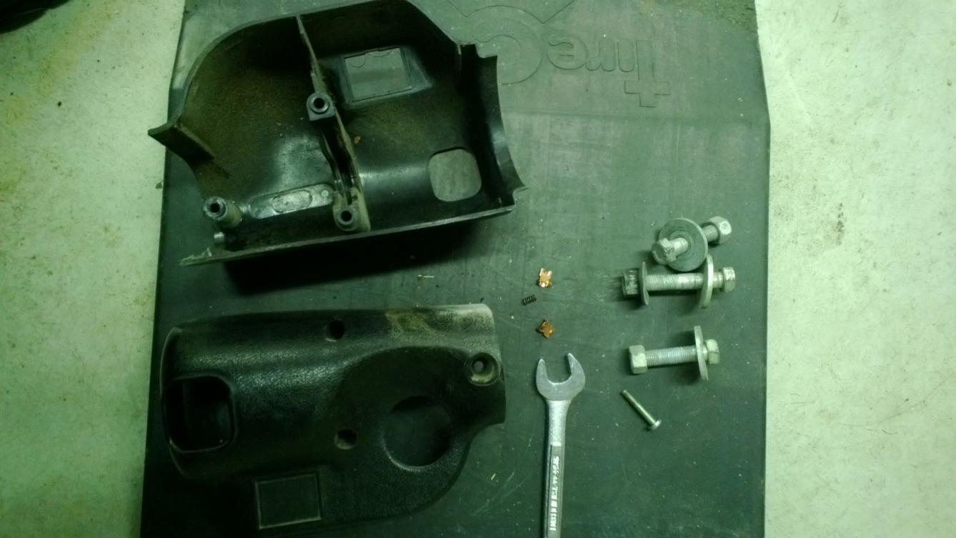

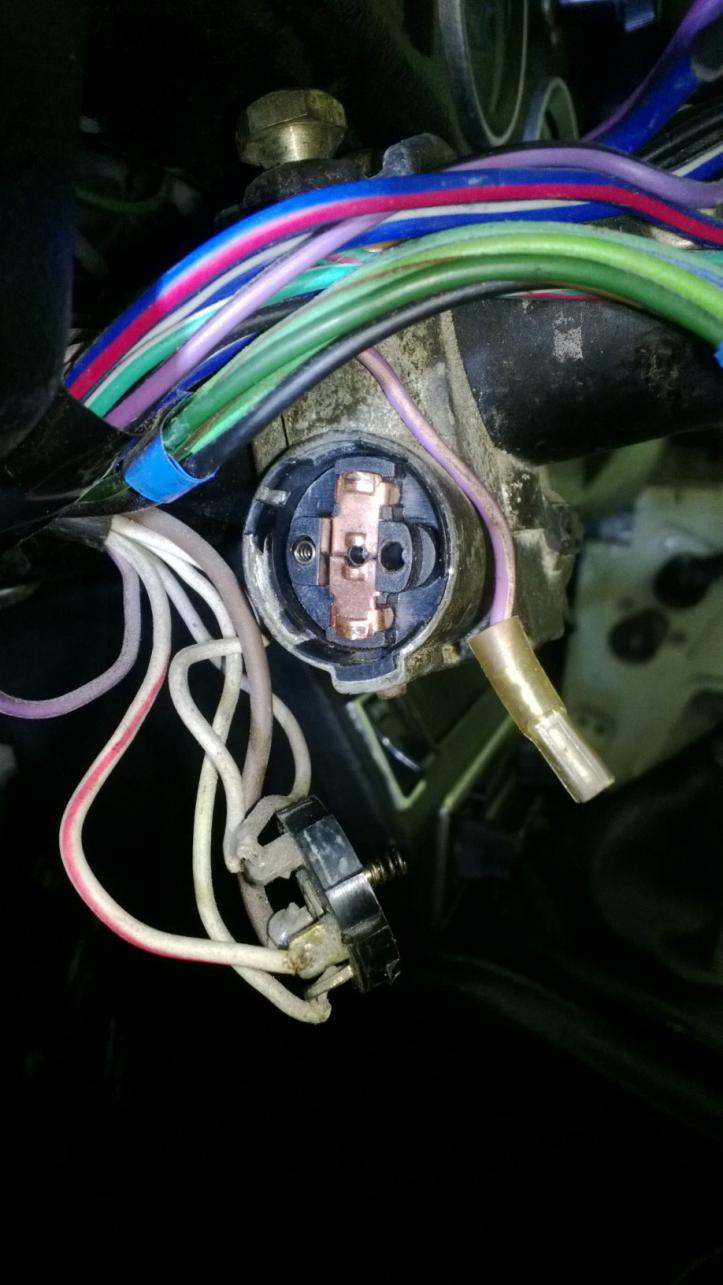

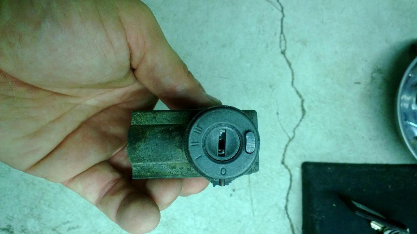

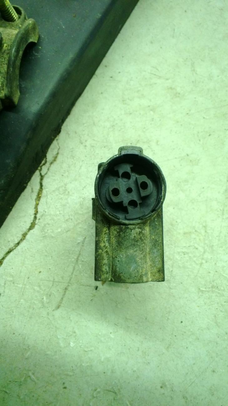

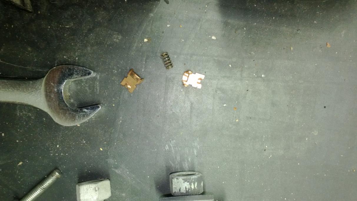

worse than I thought. Well column came down no problem, got housing off (THANK YOU GUYS!!)..mine opened right up. Man was it filthy in there. GOod news: FOUND THE PROBLEM!! Bad news: need a new ignition key/module. The back of the housing pulled out and i did manage to find allof the springs, miniature ball bearings etc and get it just about back together then saw the plastic "lock" to hold the solder board down is broken. 35 year old plastic has a tendency to do this. Even though I got all the pieces, no matter how hard I squeezed it just would not click in and stay together. Anyone got a spare for sale? I am terrified to see how much Moos Motors is going to bang me for a new one of these!

ack..this stinks..Moss motors has them as NOT AVAILABLE. Am I doomed??
