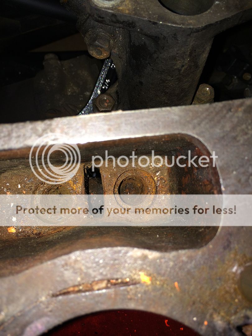

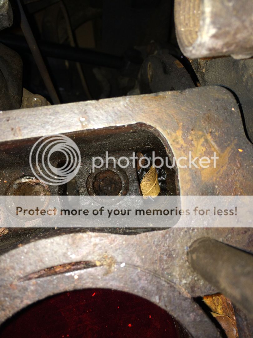

Full stop - check this out. Total rebuild time. Leaves suggest it was stored outside at some point - no way it makes any sense to try and freshen this up. Hope the block can even be saved.
Wish I had a garage floor as nice as yours.:joyous:
IMHO...I would discard that engine and buy another complete running engine, or buy an engine that is not rusted and recondition it.
Yup. But the block can probably be saved. If the lifter bores are ruined, there is a kit available that has sleeves and smaller diameter lifters.
