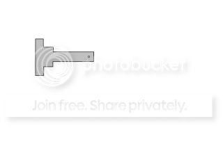

I`m no artist but here is a pic similar to what I think I need.
Does anyone have any idea where I could get the clevis pins I need?

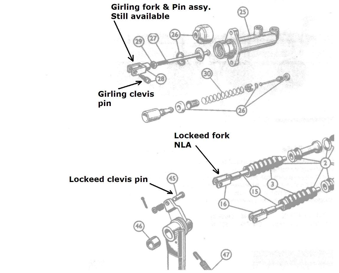

Kerry,
Here's my guess: Based on your Comm. # you have a Lockeed brake/clutch master cylinder. The pin that you got from VB is for Lockeed, but what you are describing as what you need is from the Girling system. The difference is the clevis pin assembly as fitted to the fork at the end of the push rod.
It looks like a Girling fork has been fitted to a Lockeed push rod.
Take a look at the CLUTCH page in your Moss catalog. I'm looking at Moss catalog # T24-105, page 32.

Yea, I`m beginning to wonder about these push rods I have. I know they are original to the car but there is the possibility that someone before my ownership "modified" them for one reason or another. The car is a 56 but I acquired it in 63 and as a basket case at that! When I got it, it had seats styled like the Tr-4 seats although they did have the seat pans like the Tr-3 has. {With square top seat backs}. These push rods are the Lockheed style with NON removable fork ends {they DO NOT screw off of the rods themselves} But as I mentioned someone may have drilled the one side larger in order to accommodate the Girling style clevis pins. There are NO threads, Just a 3/8 hole instead of the 5/16 like on the other side.
