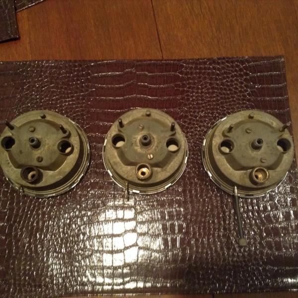

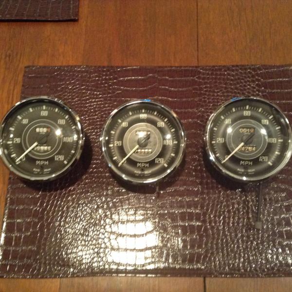

Guys, I found 3 guages yesterday, two of them, the odemeter does not work but the reset does. third one is good but little fast on speed. One of them with broken reset pinI drilled and put a longer reset rod from a TR4 on it. Works great, will do pictures when i a have a little more time. All three for sale

Ok guys, heres what I have, first two speedos run fast , reset pins are good but odometers do not work. The last one on right runs okay, odometer works. Reset pin was broke off. I redrilled hole higher up then used reset stick from old TR4 guage. Works good.

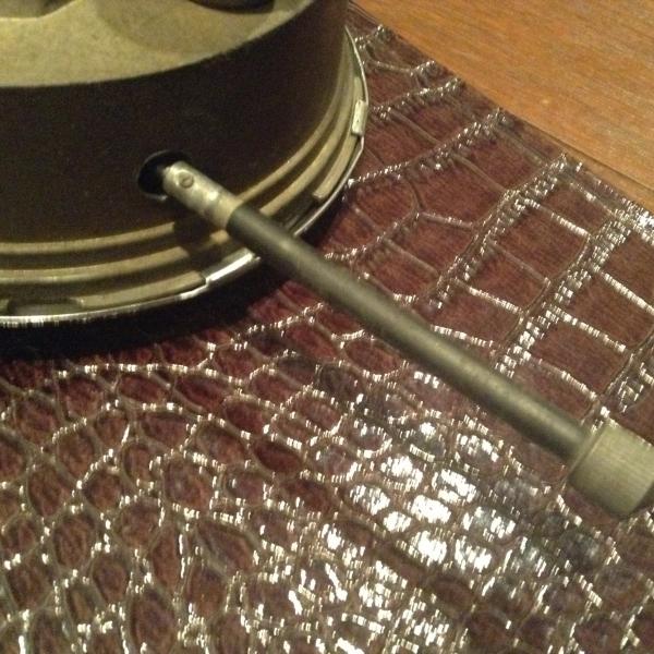

I am not sure when they changed to longer flexible odometer resets, and tin can speedos, but my 1961 tr3 had a tin can speedo and the longer flex rod. The one picture shows without the vinyl. The early tr3s I have seen have the shorter solid reset. However, I seen a ¼ longer version of the solid rest tube before and if you look at the very original black tr2 in Piggott’s book page 39 I believe there is a solid rest with a brass knob that is a fuzz longer for the tr2, but I am only surmising. So if anyone has picture of an original tr2 rest I would be curious.
