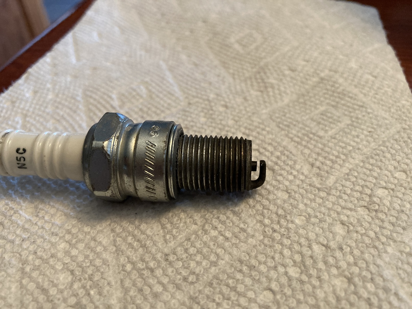

A while back I commented on my TFs engine developed a stumble when running at a high idle and higher under a no-load condition, needless to say, I tried everything to find the cause, new points condenser, rotor, distributor cap, even new plug wires, and proper ends. I was pretty sure it was an ignition problem. The plugs only had 150 miles on them so I left them alone. Checked entire fuel and electrical system, no problems. Decided to pull the plugs even though I knew nothing was wrong with them, but when I pulled the last plug, no.4, I found this, the center ceramic had broken free up inside the plug and slid down covering the end and intermittently blocking the spark. The pics are the same plug showing the ceramic in both positions. Never saw this happen in a normal running engine, even when we were racing years ago I never encountered this situation.

I opened up the plug and found where the ceramic broke. It appears to have broken on its own without anything touching it, odd, very odd.

Maybe a misstep in gapping the plugs? E.G., those slotted blades on some feeler gauges for bending the ground electrode can get into funny positions. Glad you found it.

Fired it up this morning with new plugs and she runs like a champ all the way up the scale. Idles as smooth as silk! Thanks for the comments and possible causes, much appreciated! (y) PJ
