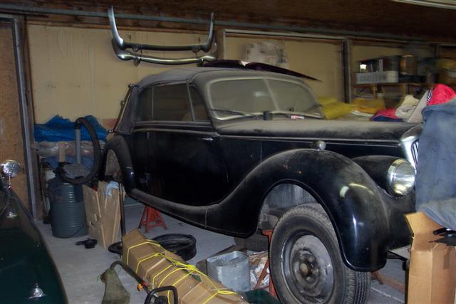

Those are big cars and take up a huge amount of space. I have 2.5L Riley that I work on in my spare time as soon as I get a bit more room the fenders are going to be taken off.
Today is a Abarth day just came in for a coffee break.
Cheers
Mark
pretty ... I'm coming to visit soon - with a trailer! /bcforum/images/%%GRAEMLIN_URL%%/driving.gif
