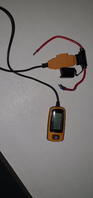

20190527_063721.jpgI did some further testing this weekend. I connected a wire directly to the battery and routed it to the cockpit, and disconnected the wire from the OD relay to the gearbox switch and routed an extension to the cockpit as well. By joining the two wires while driving I could bypass the control circuit and check the function of the gearbox switch, the OD solenoid and the OD itself. They all functioned as intended and the OD did not disengage, even when I wiggled the stick while in 3rd and 4th gear, but did disengage when I put the gear in neutral (as it should). A renewed test of the control circuit showed that it also works as intended, so the problem seems to show only while driving.
As a next step I will connect a voltmeter between the W2 connector on the OD relay and earth. If that connector looses voltage when the OD disengages during driving the problem must lie with the dash switch or the cables running to and from it. Otherwise the problem must be the OD relay, the cable from W1 to earth or the cable to C1.
I purchased the clever (and cheap) little devise on the pic. It is intended to check electric circuits by being plugged in instead of the fuse and shows the current flowing through the instrument (up to 20 amps). Plugging it into a fuse holder with a female and a male spade connector enables it to be connected in line with the wires running to and from the OD relay (and other devices). I checked the current flowing through the OD solenoid when engaged and it shows around 0.9 amps, which seems right.
