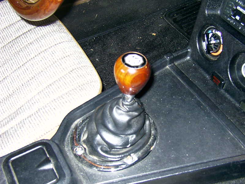

The switch & cover just snap on your original knob...look at your knob & you'l see where it comes apart.
Don't have an origenal knob.
This is one I got from Moss a long time ago.
Oh, I have them
