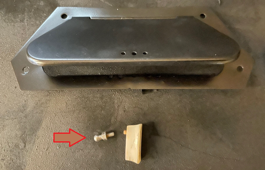

Original vents. Both heavily rusted but usable. The tiny metal catch which holds the handle on broke on one of them.

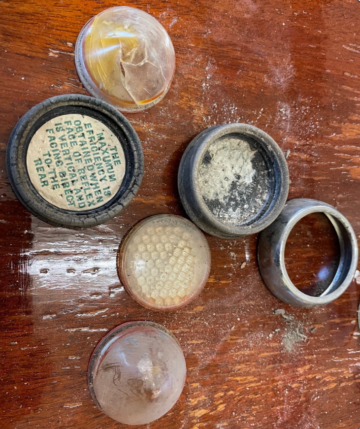

These reflectors look like they were orange and not red. Since these don't seem to exist from the parts houses will the flat red ones from later cars fit in their place?

I may have the catch pieces. will look tomorrow. I think I got my reflector covers from BCS or AH Spares. On the door seal, many are going with the 'bristle flex" material. Don't know the cost of that, though. I think it's a cheap alternative. I've heard it's preferred by some.
The conical red reflectors are available and would be correct for your BN4. The reflectors faded over time and became orange, then colourless as seen in your photos. It’s not 100% certain there ever were orange reflectors on the BN4 although there is some evidence they began with orange ones and then changed to red.

The reflectors were definitely orange. I've decided to try to restore them since new orange ones don't exist. Doing some reading this weekend I found that Krylon makes an orange transparent paint. https://amzn.to/2QPa2bO I've buffed them out and filled the cracks with superglue and I am going to try painting them. The cost isn't much so it's worth the gamble. If it works I will post a photo.
The vent catches are very small and the threads are probably 6-32. I don't see any lift-the-dot options that small. I might just screw on the pull and leave it without a latch for now. Randy if you have one I would be grateful to buy it from you.

I have red replacement NOS bullet reflectors if interested pm me. My '57 BN4 has the original orange ones.

Dougie I’ve decided to try to rehab my orange ones first. If that fails I’ll reach out to you. Thanks so much for your offer. That mint green 100-6 is spectacular. I’d never expect to love that color but I do.

I have some NOS conical covers with restored original chrome bezels

There’s a bulb dye used in the theater industry that works great. Comes in colors.
