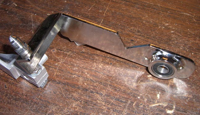

Yeah, it is a tad tricky. The biggest thing is the prep work. Pretty much any blemish will show through the plating so you have to get the parent surface smooth. If you only plan to plate the rusty nuts you have, I would just buy new fasteners. If you have more parts or you like to do that kinda thing, then by all means have at it. I have Caswell's Nickel kit and bought a 10 Amp power supply. The power supplies can get expensive. Down in the tool section of the forum, there are a couple threads about the Caswell kits. HERE is one. Also Caswell is a supporting vendor here, so you can get to there site from the supporting vendors link on the left pane.
P.S. Here is a part I plated from Caswell's nickel kit. It is for the cable linkage on the carbs.

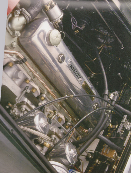

I've been looking through a lot of pictures on various engine bays, and the heater intake should definitely be painted. However, about the intake, I'm not so sure...Seen Tanner doing that, but in some of my reference books, Bill Pigott's Austin Healey (see picture), the intakes ar NOT painted. Comments? What's right?

I did read the Concours guide, which seemed to indicate that all engine parts were painted, with the exception of accessories. No doubt that the carbs were not painted. I believe it is appropriate to paint the intake manifold, for it is cast aluminum, and subject to significant oxidation if not protected. I know it looks cool to leave it unpainted, and if that is what you prefer, then go for it. I'm no expert, but believe you may find from those who really know that it was painted at the factory. If I'm wrong, though, it won't be the first time.

The assembled engine with most of the accessories installed was painted as a unit at the factory. This included the generator, fan belt and starter. The head bolts all got painted.
You are correct. However, the intake and exhaust manifolds were not painted as they were'nt installed yet. They went on after the engine/transmission painted assembly went on the vehicle. If you can picture the frame and chassis coming down an assembly line after wheels and axles, etc. the engine is installed first then auxillaries such as carbs manifolds etc.
I painted my intake manifold using Eastwoods "alumablast" and looks great. The exhaust manifold was mainted the "stainless exhaust" paint, it too looks and has lasted well.
The water pump would have been painted along with the rest of the engine and transmission. The nuts would have been on the water pump also.

It doesn't to me...
Are you sure about that Johnny? There's little doubt it would take longer to fit those parts when the engine's in the car.
Add to that the risk of damaged paint and bodywork ("mechanics elbows" dents on the the top of the shroud), especially when the paintwork was done at Jensen's.
Abingdon was strictly an assembly plant, the assemblies would arrive in as few component parts as possible; complete engines/transmissions shipped whole from the Morris Engines branch.
All the Marque books I have show completely assembled engines/xmsns on "little trucks" heading towards assembly.
I'm saying the manifolds were painted on the engines, while avoiding direct spraying of the carbs.
I have an original engine compartment and the intake manifolds were not painted engine color.
I painted the rocker cover and top of the head and the head nuts, but the intake manifold is original
Okay, but I'm still not buying the manifolds were fitted after the engine was installed in the car. That doesn't make economic/production sense.
Compare the color of the aluminum carbs to the color of the adjacent aluminum intake manifold. If that engine were completely original, would they not be approximately the same? Was that heater pipe also installed without any paint? It also appears that the plastic piece of the carb linkage has green paint on it, and it's sitting on top of the unpainted manifold. Did they paint the plastic piece separately? Could very well be, but....
According to the concours guide (See below) and others I have talked with, the
manifolds were painted engine color. I was told that the manifolds were not
prepped well and the paint quickly came off!
Excerpts from the 2009 concours guide:
“Manifolds and Heat Shield
Intake manifolds were painted on the engine on all models throughout
production(except 100M).”
“100M intake manifolds were substituted for the original manifolds after the car was assembled, and therefore were not painted. However, the balance tube between manifolds was reused and thus is painted engine green.”
"Carburetters
• Carburetter finish is bare, unpolished cast aluminum, dull in appearance.
• The carburetter throttle linkages on all cars were unpainted."

OK guys, I just checked my stash of seven intake manifolds, none of which have apparently ever been mechanically or chemically cleaned or stripped. I have 100-6, early 3000 and two BJ-8 intake manifolds. There is no evidence of any paint ever being on any of these intake manifolds.

All of the Austin-Healey documentation that I have access to (See additional example below) states the manifolds were painted engine color.
My manifolds do not show any signs of paint either, but since they were so poorly prepped and subject to heating and contraction (I measured my exhaust manifold temperature at over 500 degrees F) I am not surprised that the paint did not last very long.
Quote from the Austin-Healey 100 / 100-6 / 3000 Restoration Guide
by Gary Anderson and Roger Moment
"Intake and exhaust manifolds, and their fasteners, were painted on the engine on all models throughout production. The exhaust manifolds are secured to the engine head studs with 10 flat zinc-plated steel washers (PWZ106) and long brass nuts (AEC350); no lock washers were used. Where both exhaust and intake manifolds used the same stud, the long brass nuts were used. These nuts, of course, were also painted engine green."
