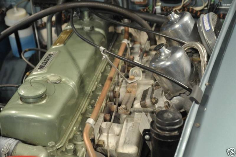

P.S. Here is a part I plated from Caswell's nickel kit. It is for the cable linkage on the carbs.
