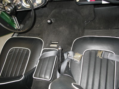

Bill, I've installed two tunnel covers and have come up with a fair solution to not having to cut the carpet. One of the big problems to overcome is the large seams that create a big lump underneath. To overcome this I glue insulation "around" but not over the seams. This reduces the size of the seam and makes a smoother edge. I also used heat to form the carpet before drilling and installing the fasteners. I also found that by tugging really hard downwards then adding screws helps to form the cover. The screws can be removed after installing the snaps and the carpet should stay there. From the factory they really weren't a form fit but still reasonably nice looking.
Just my opinion of course.
Johnny, that looks great. I might try a heat gun to relax it and then reposition the female circle snaps I installed on the carpet. I found that when I pulled the carpet tight, two things would happen. First, I made the wrinkles worse, second, the snaps would not stay snapped.
The Heritage people told me they do not install underlayment under the tranny tunnel carpet. I'm wondering of the underlayment is causing some of the problems. The male snaps are attached directly to the tranny tunnel. I have cut holes in the underlayment to allow access to the male snaps on the tunnel. So the carpet has to be stretched and pushed in a bit to get the snaps to lock. I wonder if it would be better if I glued the underlayment to the carpet and tried to fasten the female side of the snaps to the underside of the underlayment? That really sounds like a PITA, but it may make a difference.
