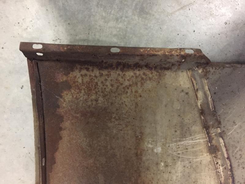

Flange is in incredible shape and the repair panel that resides in it is plain to see. Can't tell the amount of bondo, but considering the backside of the fender it doesn't look like there could be too much, but....$130! Looking to see if a relative could get it for me and ship it. Even with a load of bondo it's in better shape than mine.
I had a procedure done on my neck Monday (epidural anti-inflammatory) and felt like I'd been hit by a truck. I always do for a few days, but we have a storm coming in and had to go down to the shop to get the snow-blower ready. I looked at the fender standing there, mocking me. So I thought I'd look at it in daylight. My new shears were calling to me as I planned to cut off the old flange.

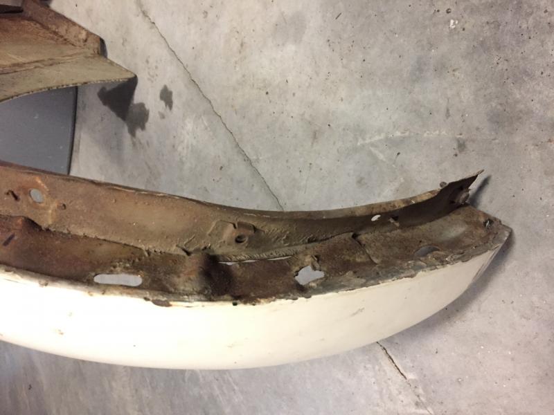

I noticed that a lot of the flange, and the top of the fender looked in really decent shape considering.
So I thought I would cut off just part of the flange to start with. I could make a new flange, though shorter, and weld it into place. Cutting the flange off just where the crappy repair was would allow me to access the back of the dented area on the front and pound them out.
This scabbed in part broke my brand new shears. So I brought out the cut-off wheel.
I cut the flange off fairly high up (about half of it) due to it being brazed, damaged, rusted and the like. I tried to cut as close to the top skin as possible since I would need something there to weld to. I had originally thought to cut it to the bend of the skin, but having to run that kind of bead right where it could be easily seen....I'm not quite there in my welding skills, yet. I then proceeded to try and get the remnants of the flange (as much as I could) out of there. While I had the tools out, I also cut away the section that my repair panel will be replacing. I'll have to replace half of the rear flange, but I saved the cut off piece so I most likely will be able to weld it back in. I have a sheet that I laid out a pattern for a second repair panel so no problem making a new rear flange from that.

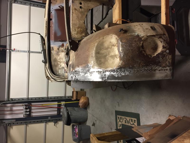

RJCOX, your wing looks somewhat familiar with what I will be faced with. My inner wing required the outer 1 1/2 (the portion with cage nuts) to be cut off and replaced. Unfortunately this was wide enough that the seam will not be covered when the outer wing is re-installed. Hence I will weld, grind, weld and grind until I get it right. I did patch this in pieces since I didn't think I could manage one long thin piece for butt welding. The outer wing has obviously been hit at one time, looks like a lot of bondo on the front. I love the picture Lionel posted of his patch, but I have neither the tools or skills so I am not sure how that will be fabricated. I also need to replace the flange and like the approach Lionel suggested although I didn't think you could bend into the correct radius curve with the short flanges already formed. Have to try that. Fortunately the back portion of the wing looks pretty good.
I have switched to using only 18 ga sheet metal. 20 ga is nice to bend but my welding skills lead to more blow through. I did buy a new welding helmet, replacing one from Harbor Freight, with good optical clarity ratings and it makes a difference. I can see what I am doing much better.

@Kerry: I'm lucky my inners were in excellent shape, just the wings. Fabbing the flange will be the easy part, getting the curve right is another thing entirely.

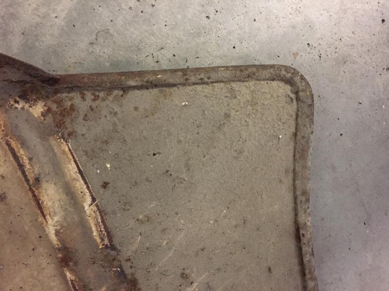

My first attempt at fabbing a panel was mediocre at best. Tried to roll metal over the wire and my bottom corner looked frightening. Gave up for the day and will grind it off and try again.
Got a good start on flange channel though. Need to figure out how to radius it.
