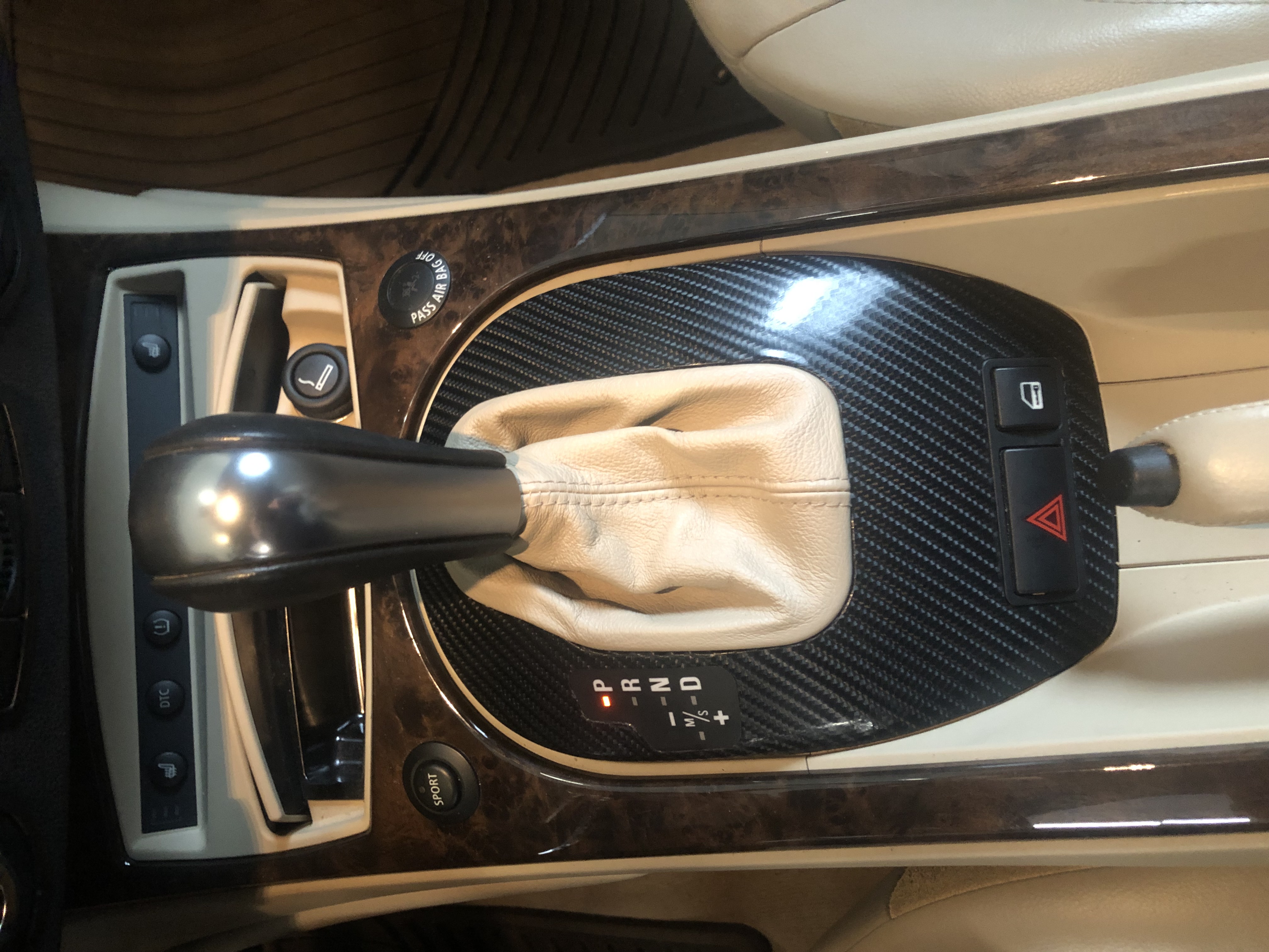

I took serious note of this Randy . I have been meaning to remove the gearshift surround on her Z4 to fix the gouges in that leather look paint they use . Anyways no full face helmet available so safety glasses on and keep out of the way . Didn’t need to pull too hard and off she came no problem . Decided to carbon wrap the surround ….she approves so it’s all good .
No part time BMW techs were injured during the course of said work 😎
