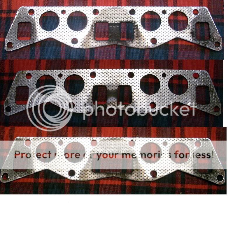

If you spend more than an hour changing the exhaust manifold gasket.....sigh.
Easy job, remove heater hose bypass, after draining a bit of water from the radiator.
Remove fuel line at carbs.
Remove 5 manifold bolts, tilt both manifolds away from engine together, reasemble is reverse, lol.
