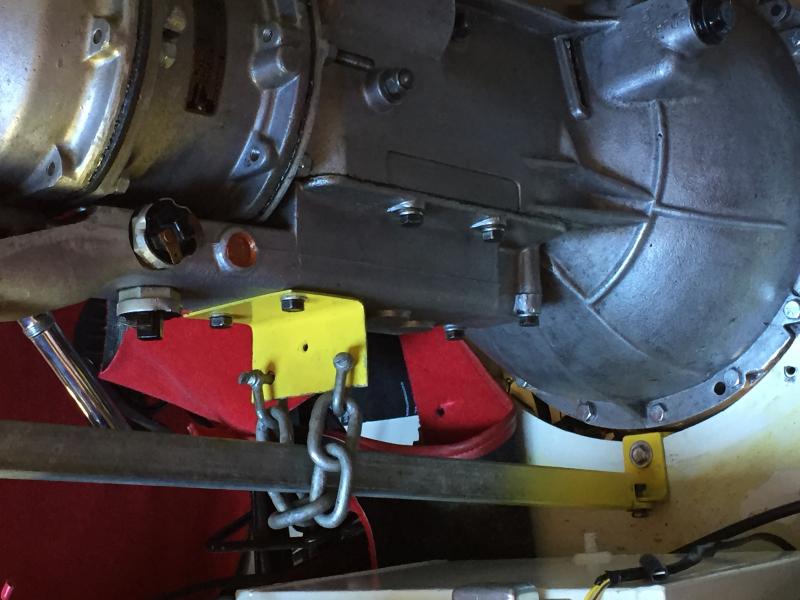

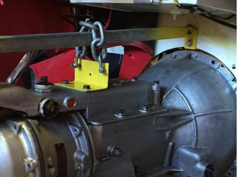

I changed my gearbox on my own using my lifting bar but you may need to take the steering wheel off I don't have that problem because all the controls are on the right-hand side of my car. If you go from inside don't forget to tie the clutch lever forward to the bell housing because it tends to get caught on the floor turn up when putting the box back in.
Graham
upside down again
Clever arrangement Graham. I flipped the image below:
