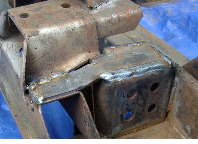

while i'm doing nothing else i was thinking about suspension einforcements - since i just paid a lot to get the back boxed in and the engine is out.
anyone put the secondary reinforcements across the front? not the extra vertical 1/4 rounds that come on the 72+ frame, but the other horizontal pieces that tie the lower a arms to the frame?
worth the cost?

if you mean the horizontal piece that connects the front lower a-arm mount to the steering rack mount then yes, i have done this. i had a bare frame to work with so did everything. see photo

That's exactly the bit I mean. The engine is out, so I could have it done without too much aggravation now. Is it worth it though or am I just looking for stuff to do?

Now is the ideal time to do it. I can't quantify the benefit but it is a recommended upgrade in numerous publications. It should add strength to the suspension mounts and also rigidity to the steering rack mount. Two pieces of 1/8inch steel cut to form and welded....done.
ROger Williams recommends this in his book.
