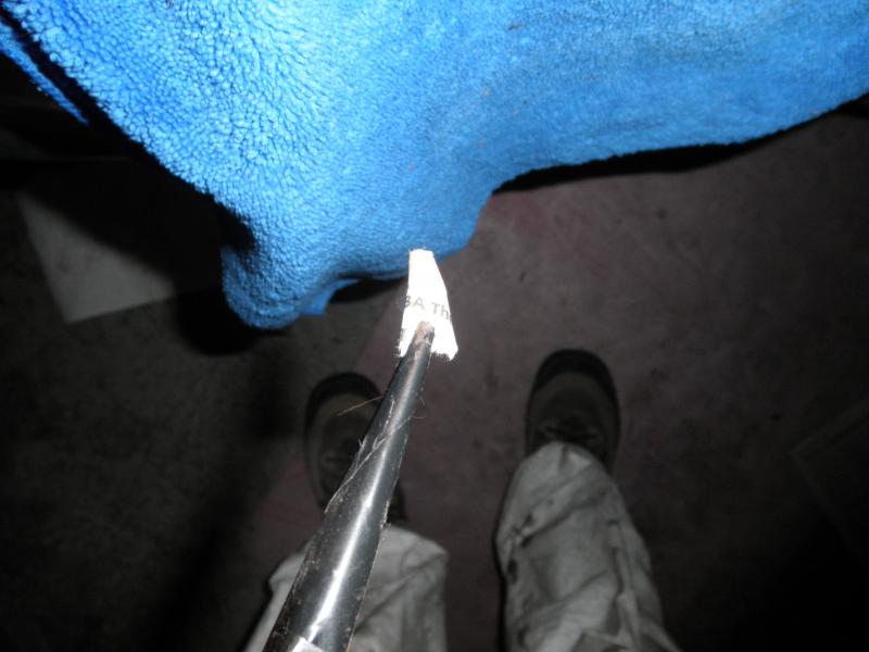

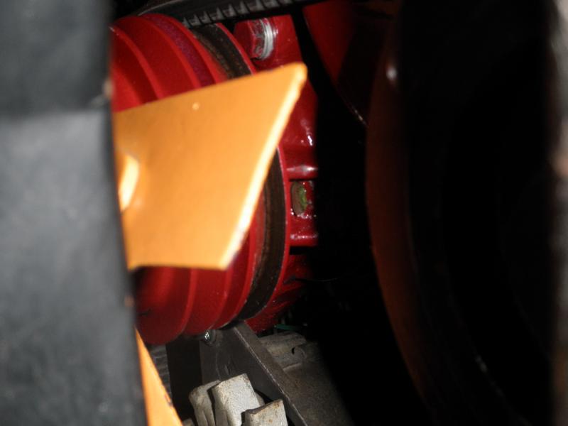

Well, I have found the real source of the leak. It is the weep hole on the pump. Today I put in the coolant and started it. After it warmed up with the radiator cap on I started see drips on the bottom edge of the pump flange, but I could not see where they were from. I rolled up a small piece of newspaper and stuck it in the weep hole (not while the engine was running). This paper roll was long enough so that instead of the coolant running down the glossy painted flange, it collected at the end of the roll and then dripped. Pics are attached, I hope.
